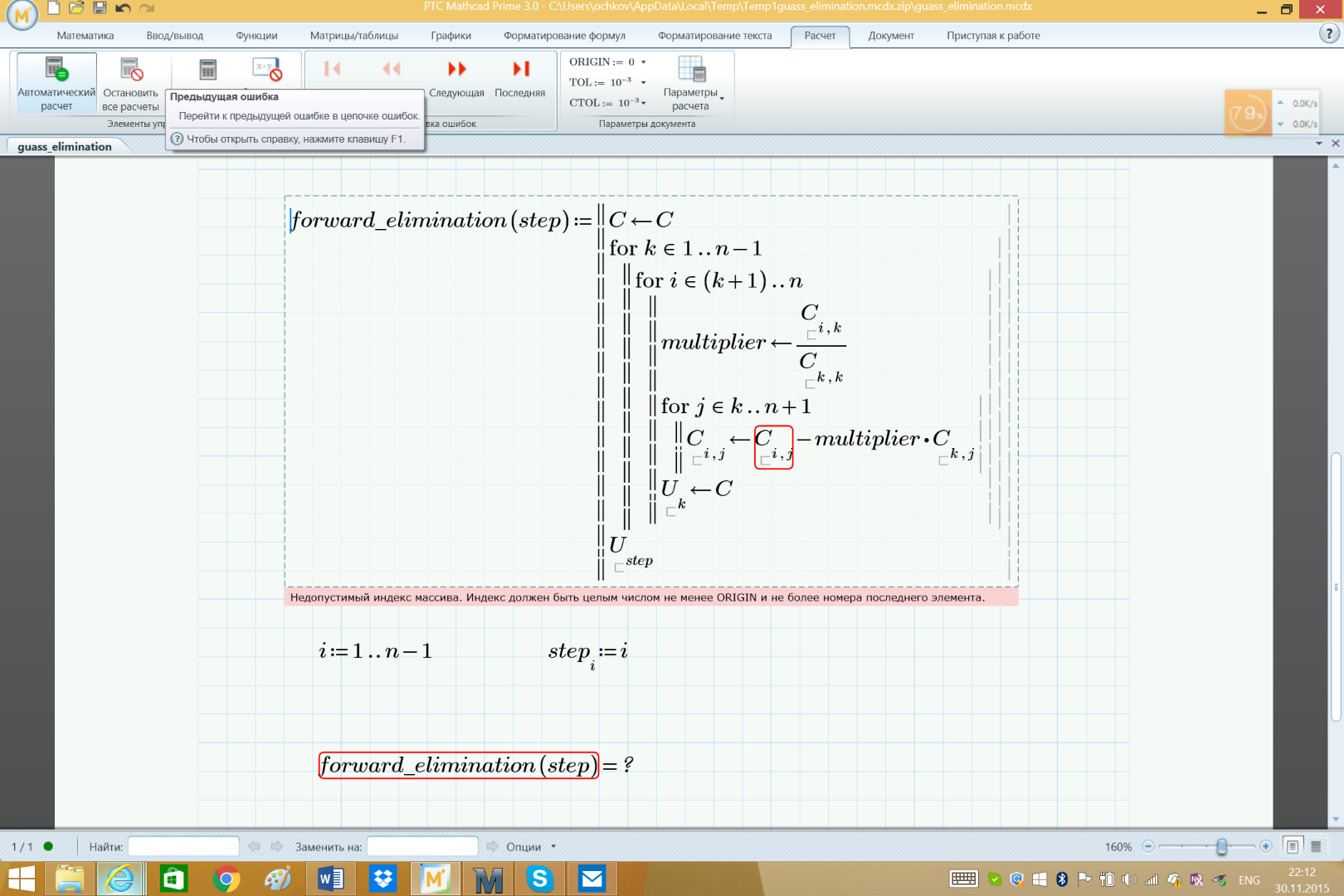

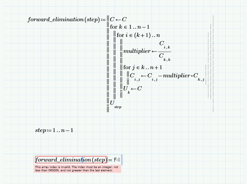

I am trying to do guass elimination method in mathcad, but not able to do as it gives me below error.
please help.
I have attached mathcad file as attachement. mathcad file is created in Mathcad prime 2.0

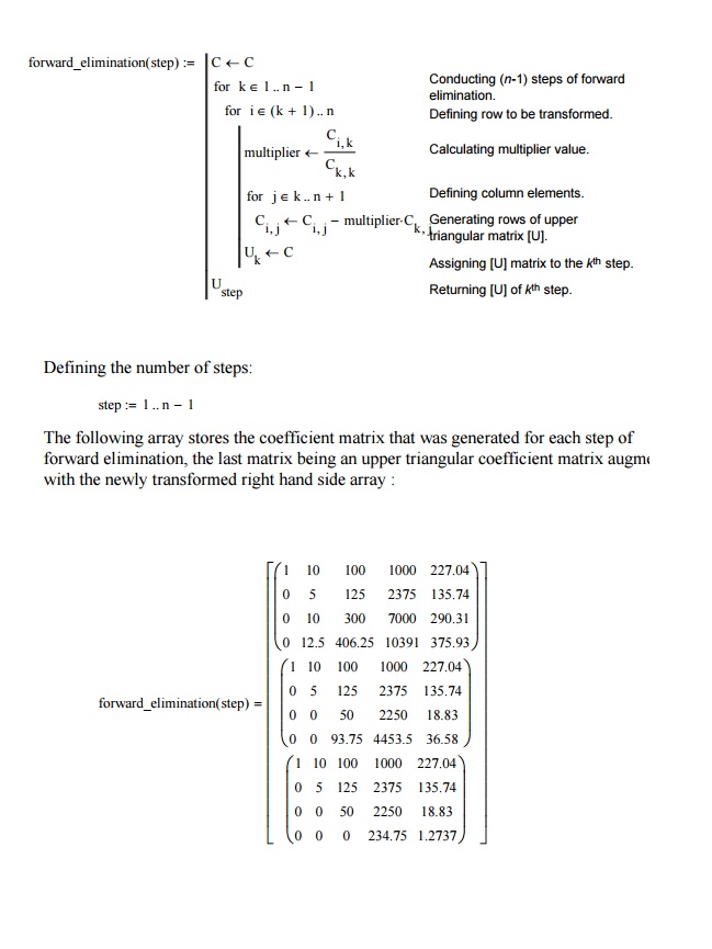

First of all i am trying with given example
then actual we need to solve 25 X 25 matrix by gauss elimination method.

By default, arrays in Mathcad have origin 0, not 1. So the rows and columns go from 0 to n-1. Either that, or change the origin to 1 by typing ORIGIN:1 at the top of the worksheet, in which case the rows and columns will go from 1 to n.
When k is n-1, i=k+1 is n, which is outside the bounds of the array (unless you change the origin to 1).
