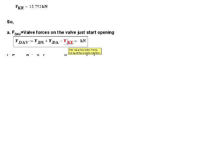

Not able to solve a mathematical expression.
Though one of the 3 variables (of same units) is already defined & worked out but still in the final expression (using these 3 variables) for this particular variable it shows the following warning msg that "This value has units: Force, but must have units: Unitless" & not provoding the result in kN.
Kindly suggest to resolve.

Would you please upload a worksheet. It is hard to tell what the issue is from that screenshot.
Jun 5, 2014 7:17 AM UTC
At least one of the two variables F.DS and F.DA seem to be unitless and isn't defined with dimension force.
As Mike already said, we can not tell more without seeing the sheet with the definitions or calculations of those variables.

Thanks Mike & Werner for the prompt reponse.
Sheet is attached for ref.
Jun 5, 2014 8:58 AM UTC
How about the attached?
