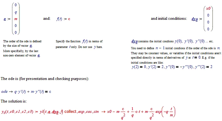

 I am trying to solve a second order ordinary differential equation.
I had attached mcdx file for reference.
It says " This Value must be a function".
Please suggest the solution if possible.
my final requirement to plot the x(t), x'(t) & x''(t)

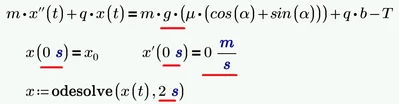

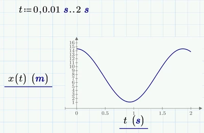

December 14, 2018
December 14, 2018
Thanks a lot ValeryOchkov for quick solution of my problem.
December 14, 2018

There are other ways:
Attached is a Prime 5 file with a plot of this solution.

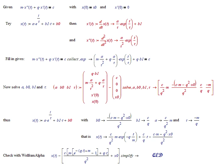

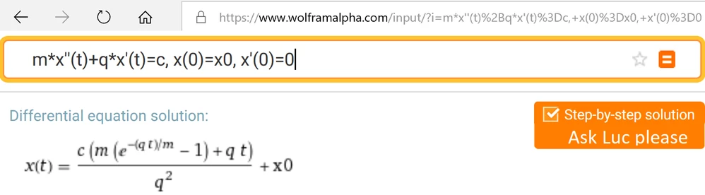

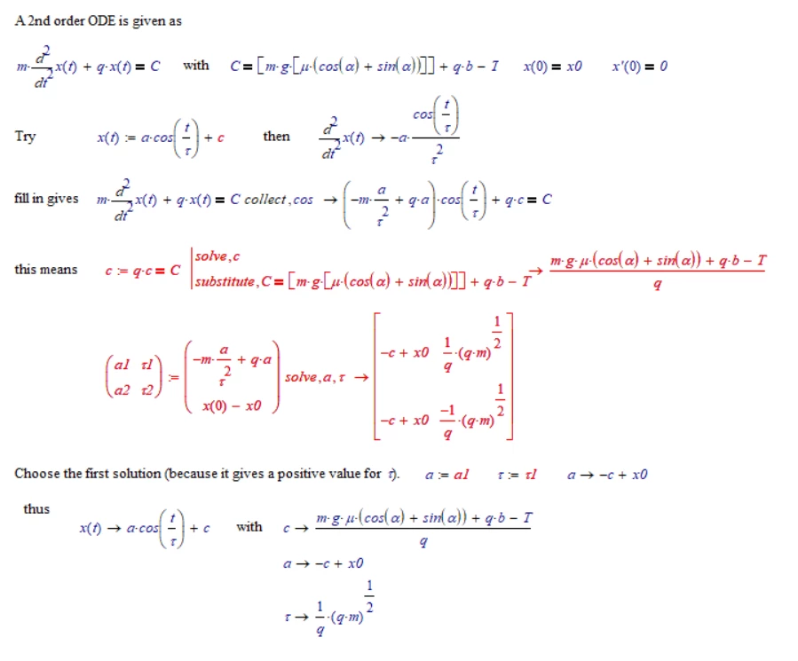

December 15, 2018
Like this...Valery?
Or did you want to see the quick method:
