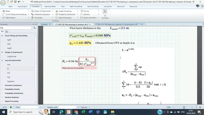

Formula does not have consistent units.
14 replies
terryhendicott
Mar 24, 2024 8:04 PM UTC

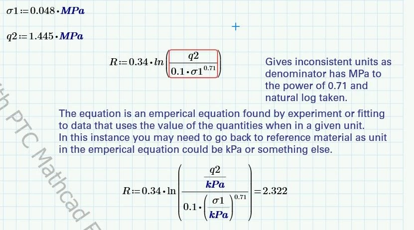

Mar 24, 2024 8:10 PM UTC
Thank you so much for your help
