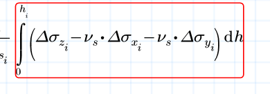

I hope everyone is doing great. I need a help to solve an integration that linked with summation also. I will be very pleased if anyone can help me. The problem is in number 2. I am also giving the main file of the task.

Just looking, but I think your integral
is all constant terms that could be pulled out of the integral. the integral then evaluates to h_i and the summation should evaluate.

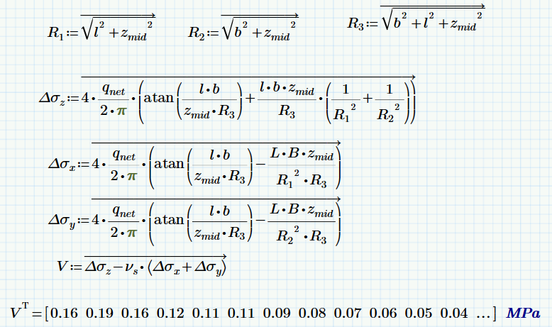

Following up.
(In the future, send a Mathcad file, not an xps.)
There were several places where vector lengths had to be adjusted to match.

Thank you very much for the help. Can you please mention why did you use the ( Ctrl+shift+^) for finding the solution or what is the name/use of the operator. I am trying to search the help file but since I don't know the name, I can't find it.

"Cntrl+shift+^" is the vectorization operator (matrices/tables\operators) and results in the arrow over an expression, meaning, "do this operation on each element of the vectors separately."  It results in a vector result.
Why did you think I hadn't used it?
That is also the reason I had to add elements to your vectors for z and h--all of the vectors in an expression have to be the same length or vectorization will crash.
