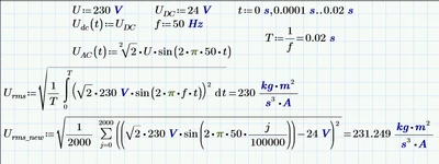

Why is my answer unit not in Volts (V), and how can I change the unit?

Although Mathcad is pretty smart when dealing with unit conversions, it can't handle some, such as the square root of a volt.

ttokoro
Sep 28, 2024 10:11 PM UTC
Square v(t) not sin only.
t.t.

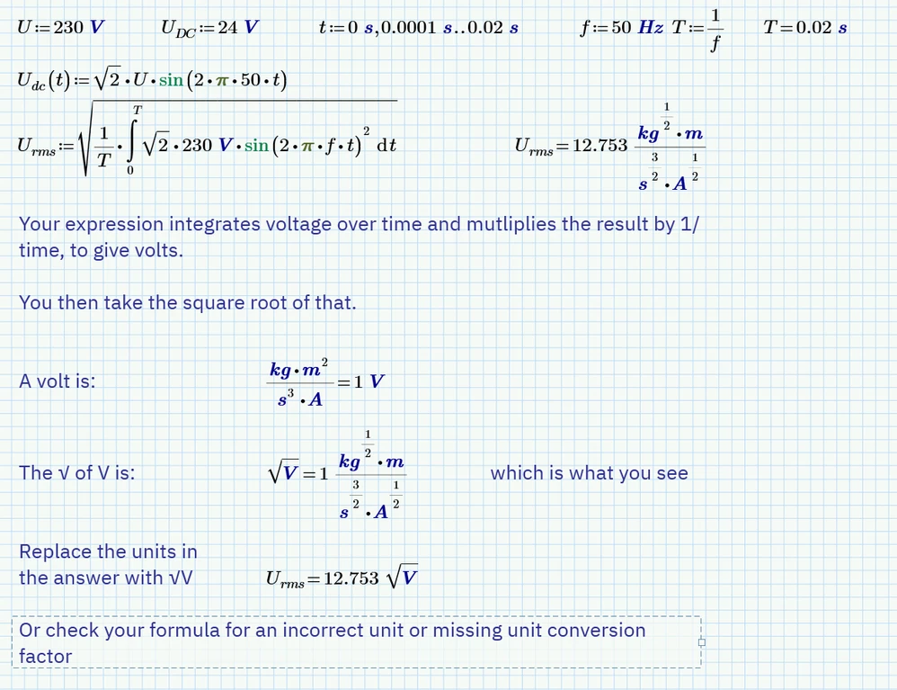

Sep 29, 2024 12:14 AM UTC
@StuartBruff
The whole expression under the root is squared, not just the sine. So the result actually IS volt
@SZ_11156868
The result you get is correct, but Prime choses to dispplay it using the base units of the units system you have chosen.

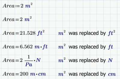

You always can override this by simply editing the units and replacing them with the unit(s) you would like to see. If necessary Prime will automatically change the number in front accordingly or add additional units if necessary.
@ttokoro had just shown with a screen how it look like when you change the expression in the unit placeholder of the result to V
Some examples:

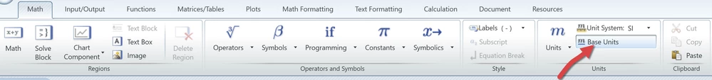

Ahhhh!!!!
I just noticed what the problem is.
When it comes to volt, it should not be necessary to manually change it , unless ....
...unless you checked the "Base Units" button in the "Units" menu on the "Math" ribbon!
Uncheck that button and you should see "volt" immediately 🙂
