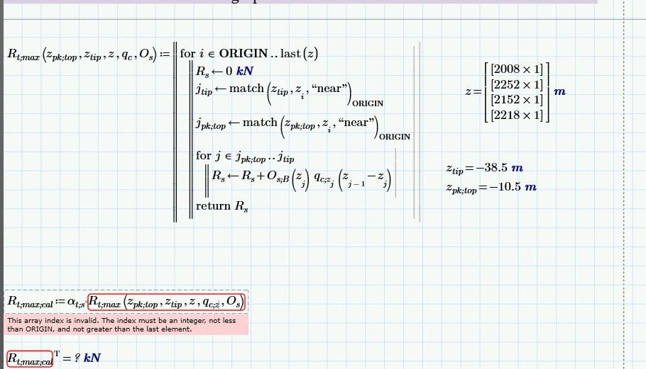

I always face this error and I don’t know how to solve this . I need to find the difference between 2 levels in  same z which has 4 rows like it do the same calculation for each row separately
Than I have to find the average and minimum value for this results
I attached simpler mathcad in zip file

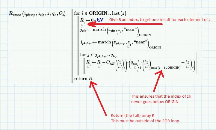

Jul 7, 2026 8:41 PM UTC
Hi Yusra,
See if this works:

Jul 6, 2026 5:47 PM UTC
Hi Yusra,
Your array z has only 4 elements. The j-values in the ‘For j element of….’ j can run between 0 and 2000+, due to whatever the match-es find. Inside the For-loop you try to access z[j (3 times). Shouldn't you be using (z[i)[j ?
Ah. And in your simple example you show that your array q.c;z is also a nested array. So you'll have to do a similar addressing there.

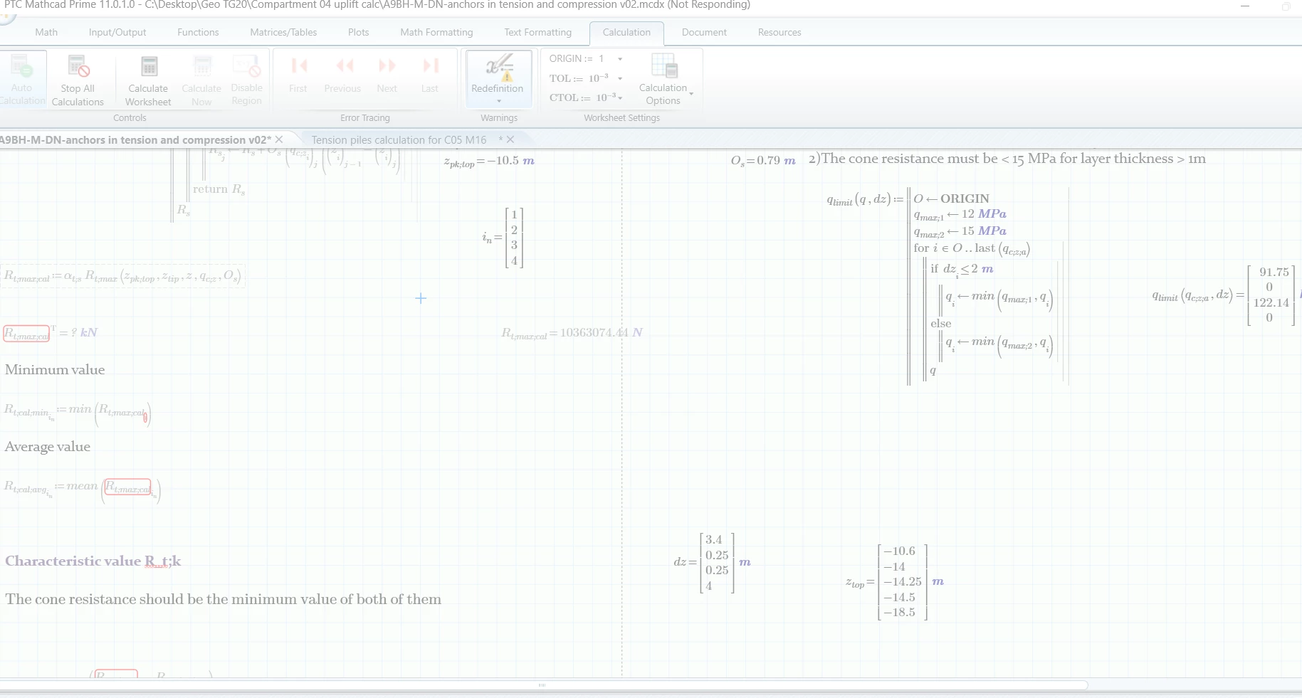

Jul 7, 2026 6:00 AM UTC
Unfortunately it freezes .. it seems it will work but Mathcad stops responding
Hi Yusra,
See if this works:
Jul 10, 2026 6:59 PM UTC
Amazing thanks for the answer
