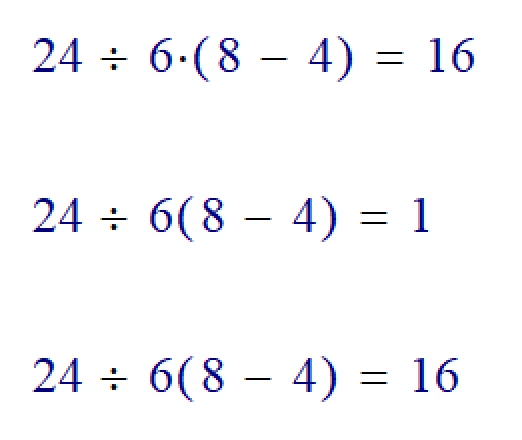

There's no maybe here, it's exactly clear what's going on. In Mathcad (11 or 15) there are two division operators that work exactly the same, but look different. You have : and you have /.
If you change the : to / you immediately understand:
The mathcad 15 xmcd sheet can be explored easily, since it is an xml file. In there you will find that for the second case (the lower left expression) the 6 and (8-4) are together surrounded by (implicit) brackets. wheras in the first case there are explicit brackets, only around (8-4).
Advice: do not use : for divisions.
Note that further confusion is possible due to the 6(8-4) wherein 6 could be viewed as a function. In fact you can actually define a function  6 (that is: 6 with a space in front of it, or even a non-printing character) that you can have perform any function you like, thus adding to the confusion.

It gets worse, this is Mathcad 11. Admitted, you have to be persistent to get this, but it's possible:
I guess Mathcad 15 will show the same...

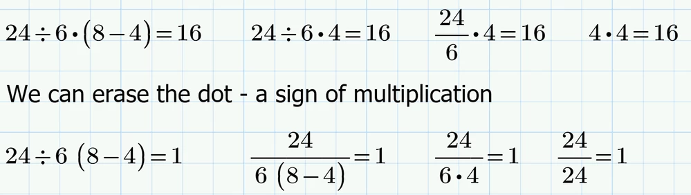

February 1, 2020
I have download your Mathcad 11 sheet and add new operator with the changing a dot to no space!
February 1, 2020
Hmm, and I thought that the answer to everything would be 42 .... Werner_E_1-1580598454847.gif
February 2, 2020
My example is without cheating!
It is a Prime bug!
