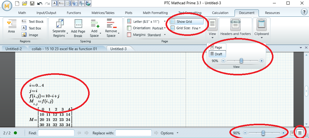

You can change the grid size from Standard to Fine to get closer vertical separation between regions.  In fact, if you change from Standard to Fine, the regions get closer together, and further apart if you go from Fine to Standard.   This will probably help you a little bit () but is, in general, a Very Bad Thing  (I want the grid to give me the ability to align regions with a given physical spacing not act as a variable-size mesh to hang regions on to).
You can change the zoom from either the Document Ribbon or the slider at the bottom right of the Prime window (status area).
Are still there the pages on the right in MP ? They were useful, at least for me, as "notepad" area, for "recycling" expressions, tests,...
Yes, they're still there, but for some unconvincing reason you can't print them.  In the Document Ribbon look for Page and Draft buttons in the View section, or in the status area next to the Zoom slider.

You can change the font size in Prime and it does have page zooming. Prime has a lot of limitations compared to Mathcad 15, but I don't think there's any real difference to how many lines of calculation you can fit on a page.
Yes, there are still pages on the right. In Prime the default view doesn't show them, but you can change the view to a continuous whiteboard, similar to Mathcad 15.
