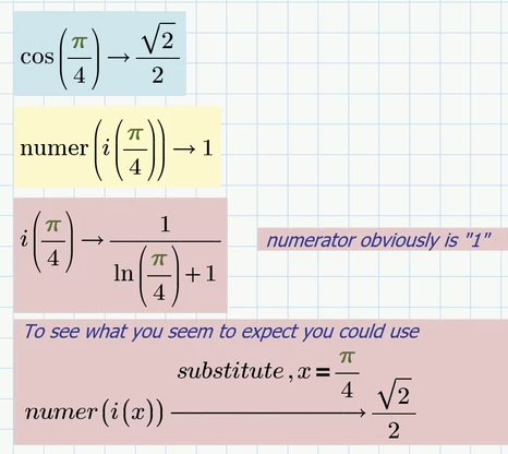

Dear all,
I'm exploring the functions:
  • numer
  • denom
And I've encountered the "oddities" in the joined MathCAD file (see what highlighted in pale yellow and the text; in pale blue some reference results for information)
To be honest I suspect multiple bugs...
If I'm wrong (i.e. we're not dealing with bugs...) , can someone explain me the logic under the quoted functions behavior, because I really cannot understand...
Many thanks in advance & Best Regards

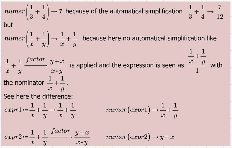

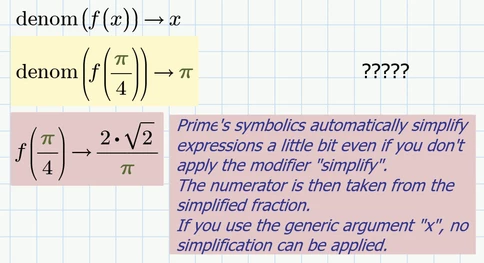

The "hidden logic" is that sometimes the symbolics applies automatic simple simplifications and nominator and denominator are taken from the simplified expression:
Function 1:
Function 2:
Function 3:
Function 4
Prime 9 sheet attached

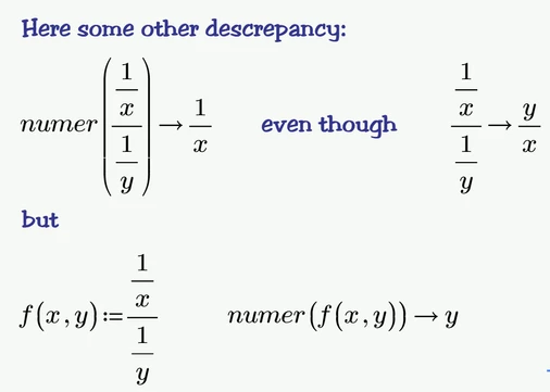

BTW, the 'logic' is not always that clear. For example
Werner_E25-Diamond IAnswer
