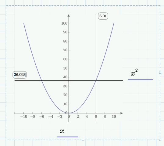

Feb 25, 2015 7:02 PM UTC
Feb 26, 2015 9:24 AM UTC
Adding markers is not exactly what I was looking for... But can you set the intersecting point of the markers to follow the trace and then drag one of the markers around?
Feb 26, 2015 1:28 PM UTC
Not in Prime, no. In Mathcad 15 it would be possible to rig up something like that using some scripted controls, but scripted controls are not available in Prime.
