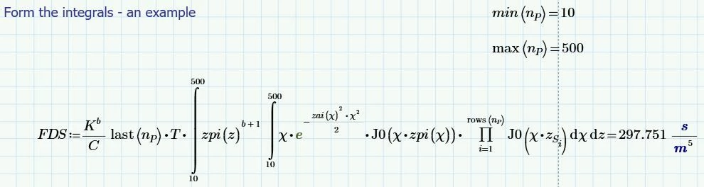

I can show how to do the integrals but the J0 in the post has two parameters while j0 in Prime has only one parameter so do not understand the full syntax of the whole integral.

The text seems to lack the usage of multiplication dots, so I guess that J0 is not supposed to be Bessel function with two arguments but rather the argument should be a product.
Numerical integration can't use infinity as integral limit. So you either have to use symbolical evaluation (with all its limitations) or use a large number as upper limit as Terry had shown.
Next problem is that z.a should be a scalar, but in the sheet its a vector!

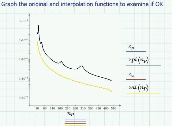

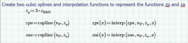

Not sure if this is correct as no idea what is the x axis of the graph and have just taken the interval np.
It does show you how to proceed to get a working integral:
