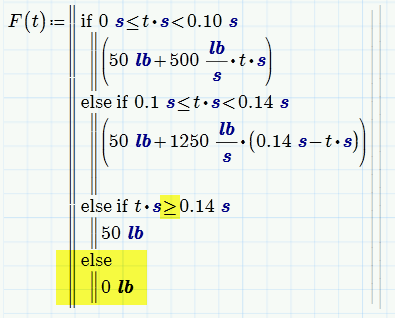

Your function F() must return a value for negative arguments, too. thats what the error message is telling you.
And in my opinion you should add an = to either of the 0,14 limits

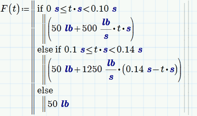

and I guess this should do the job as well
WE

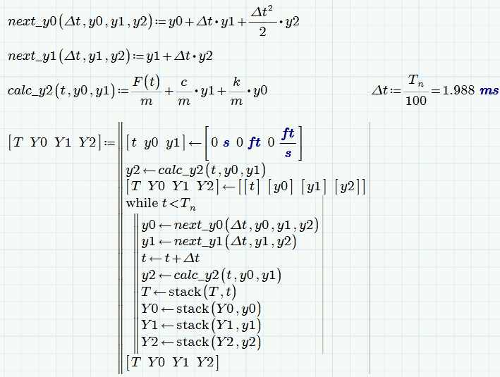

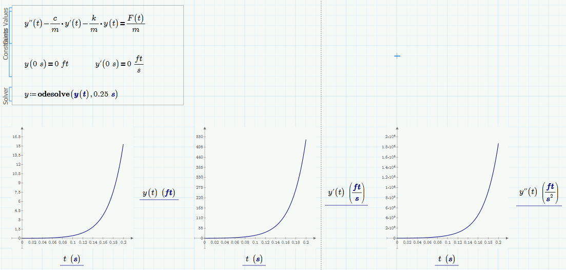

Werner, thank you the reply. But, i was expecting a "for" and "if" loop statements using equations 2b, 3a & 3b. i am familiar with the odesolve within the mathcad.

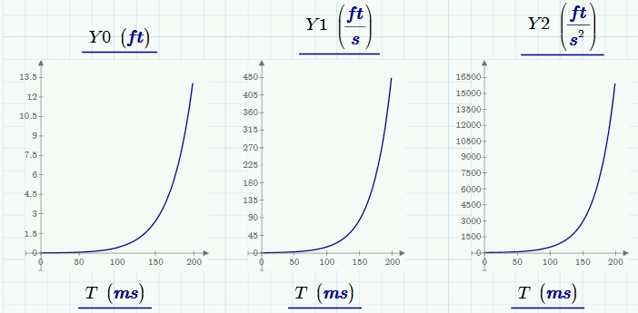

Something like this, I guess:
Have changed Delta_t to get a  better resolution and accuracy:
Regards
