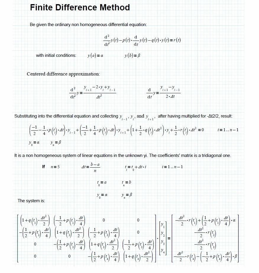

Hi RA,
you could use the finite difference method below:
November 13, 2017
Yes, FDM is one of the several ways, and thanks for sharing that program with us. The time intervals need to be no more than 1/10 of the peak forcing function, which means that the number of iterations for a 2 sec response would be in the thousands.

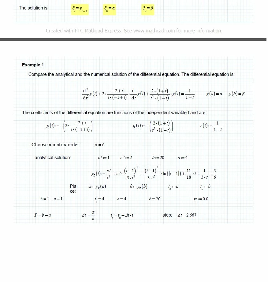

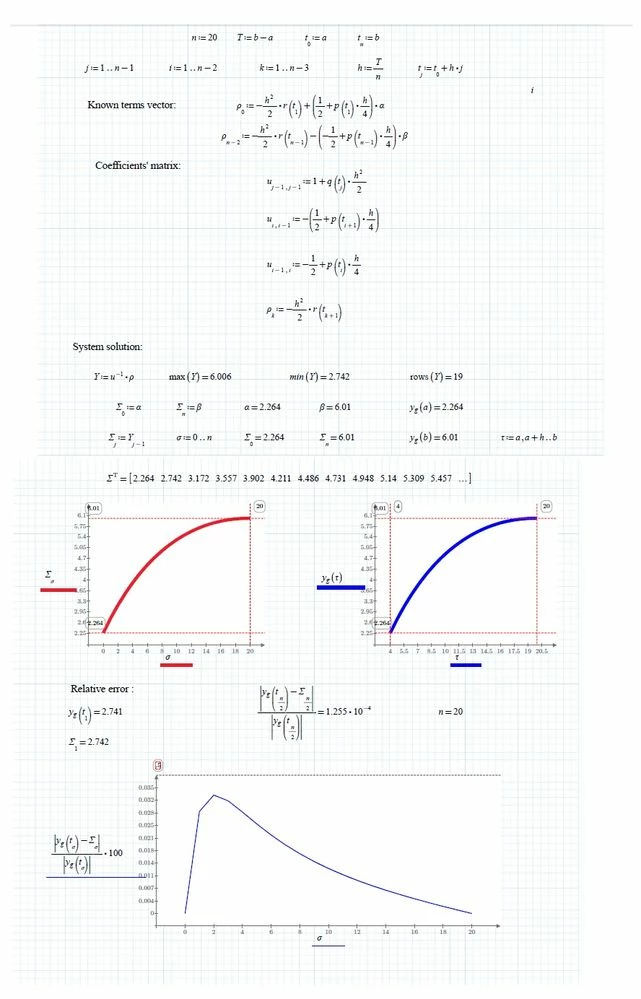

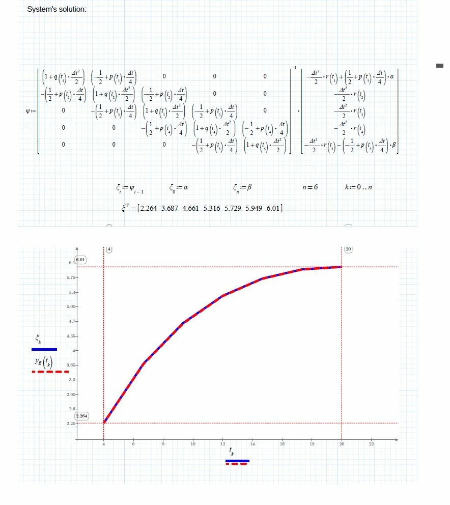

Hi ,
For any order matrix, you can do so as indicated below:
