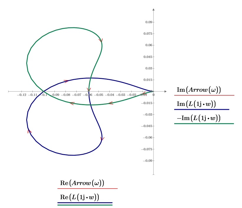

Sep 20, 2023 11:29 AM UTC

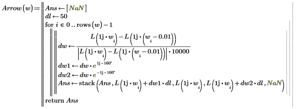

First one's arrow size dependes on dL(w)/dw. If you want to plot same size arrow, Just do below.
t.t.

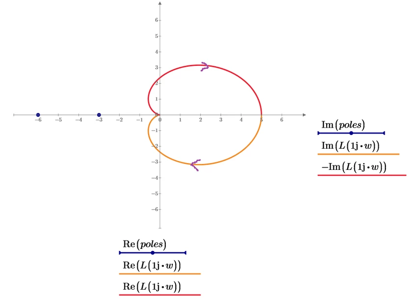

Sep 20, 2023 8:03 AM UTC

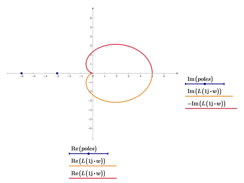

The relatively easy part is:
with which you can:
or:

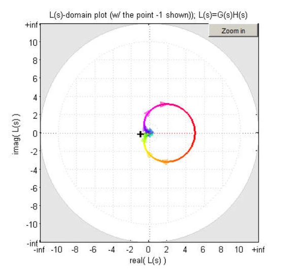

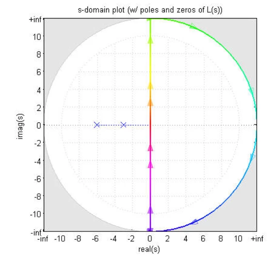

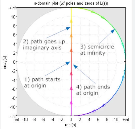

How to make/take into account these arrows in the Nyquist Plot? We can see that Matlab take into account these arrows...
There are 2 questions:

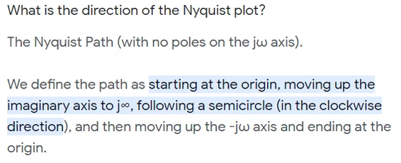

1. How to find the correct direction for each arrow?
2. How to plot these arrows?
