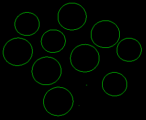

Currently, I'm working in a people counting project.
As a start, I want to make a program where given this image of a group of coins:
one can authomaticaly count how many coins are there in the image.
With some matrix manipulation, I've issolated the coin borders:
And now I want to know if someone can help me in counting how many of these round blobs is there in my image. That is, the program that I want to create must tell me: "there is 10 objects in the image"
Any ideas?

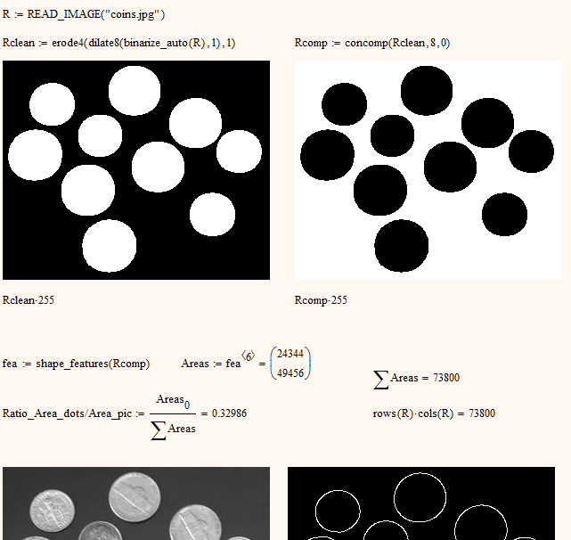

I remembered the function shape_features() which gives a lot of information about shapes in the pic, but either it isn't suitable for yourproblem or I am not able to use it correctly, anyway it will see all 10 blobs as a single shape.
Nevertheless with the help of the very helpful Image Processing E-book that comes with Mathcad I think I found a way to get filled blobs very easy and without trickery. Guess counting will be easier with those shapes.

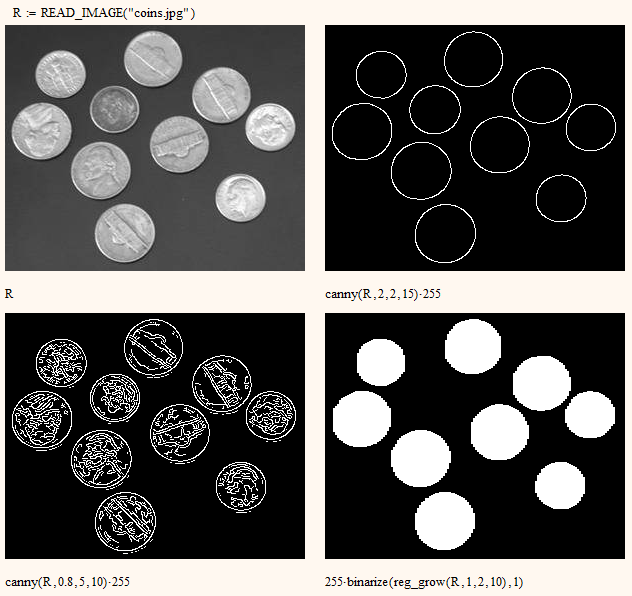

Isn't that something which Mathcads Image Processing Tools can do out of the box? There are quite a couple of different Edge detectors available to chose from. How to automatically chose appropriate parameters for pics with different intensity gradients may be the next question. I'm no expert in image processing but I could imagine that some of Mathcads analysis histogram functions could help in finding those values. Maybe it even makes sense applying levelmap() or equalize() before going to the edge detection so that there is a uniform transformation on intensity levels throughout. Just some thoughts, no expertise.
BTW, I guess that detecting and counting blobs could be easier if the shapes are fully filled.
One way I could image to count blobs could be to run through the pic (I assume filled blobs as at the bottom right) and when you arrive at a white pixel, you apply some kind of floodfill algorithm - without changing the pix, just to get the dimensions of the object (so you don't need a full fledged floodfill, just be sure to get width and height of the object). Collect the rectangles found that way in a list and go ahead scanning the pic. For every white pixel you check if the coordinates of the pixel are already inside one of the rectangles in the list, if not -> new rectangle found.
In case you didn't notice: In the bottom right pic I was cheating as I told Mathcads reg_grow() to color 10 regions, so i was using already the known number of coins 😉

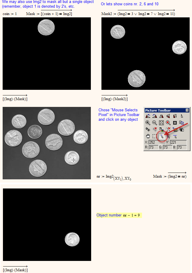

Find attached a solution to your counting problem. I have implemented a simple (but at least non-recursive) floodfill algorithm and it performs really awfully slow. The object count routine will not only return the number of the objects counted but also an image matrix where the background is all zero, object 1 is all 2, etc. This can be used to mask the original picture, show just one selected object, etc. Just for fun I included a way where you can click on any of the coins in the original pic and only this coin is then shown in another pic. Not of use, just done because I could 😉
