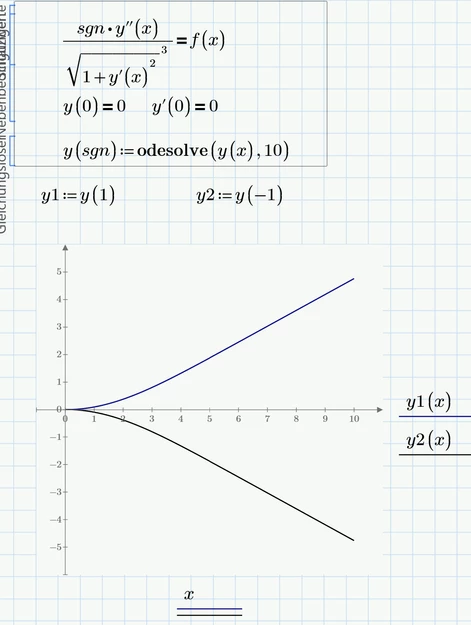

How about
You can avoid the numerical glitch at about x=7.7 seen in the pic either by setting TOL to 10^-6 or lower or by adding 10^5 as the third argument (intervals) of the odesolve function
Werner_E25-Diamond IAnswer
Oct 6, 2023 7:20 AM UTC
How about
23-Emerald V
Oct 8, 2023 10:07 AM UTC
The derivative of the function y(x) you are looking for, so y'(x), is (+ or -):
where c is a constant.
Proof:
To find y(x) you have to integrate this function y'(x), which will give you another integration constant.
