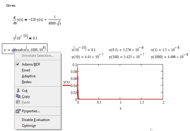

I am using Adams to solve the differential equations as below but failed, may anyone could suggest how to solve it or should I use another equation.The error can only disappear when x was deleted in the equation.
PW_10297783_1-1705961895174.png,x from 0 to 10000
Thanks in advance.

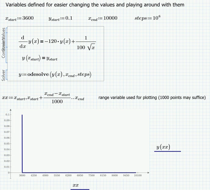

Your sheet is still missing - its not attached.
I see that you changed the initial value for x significantly now from 0 to 3600!
In Prime you would have to use the commands inside of a solve block!
The syntax for odesolve had changed, too, from legacy Mathcad to Prime (look it up in the help):
The attached file is in Format of Prime 6., so you should be able to open it with P7.

Jan 23, 2024 1:00 AM UTC
You have to write y(x), not just y.
Furthermore I guess you will run into problems because the right hand term is not defined for the start value x=0 (division by zero).
I changed the start value to x=10^-10 and it works OK.
Here done in Mathcad 15 using "odesolve" with Adams/BDF chosen as algorithm.
I let x only run up to 1000 - you can see that y approaches zero continually.
For further questions please attach your worksheet, not just a picture. And in case you are using Prime also state which version.

Thank you Werner,
Please fine my error enclosed.I am using Prime 7.0.
Thank for guiding me how to proceed.
