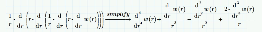

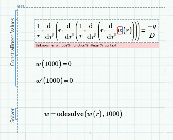

I am trying to solve a differential equation for a clamped Circular Kirchhoff-Love plate.
Why am I getting this error in my displacement function w(r)?

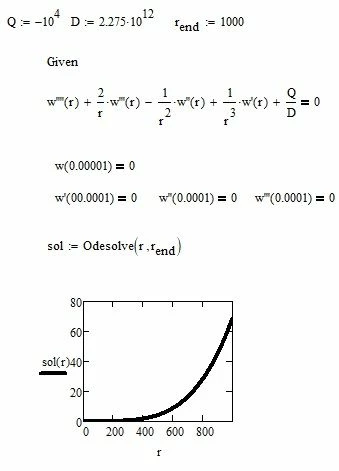

So we can't use w(0)=0 as initial conditions as I did and you need to provide a new fourth condition.
How about w''(0)=0 ?
EDIT: I am not into mechanics myself so I am not sure but maybe Chapter 4 here
http://imechanica.org/files/4_Bending%20of%20plates.pdf
can help you to find two reasonable additional initial conditions.

Attach please the Mathcad Prime sheet!
lferreira1-VisitorAuthor
April 4, 2018
Sorry, the .prt with the embedded sheet is attached.

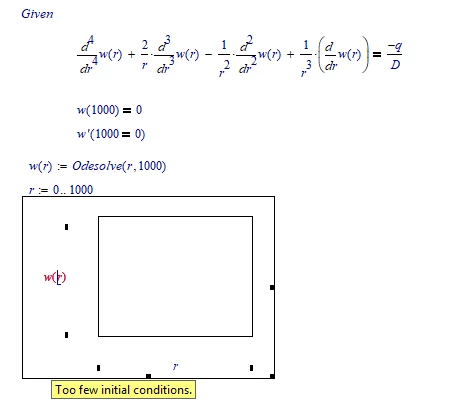

I would have expected 4 initial conditions for a fourth order DE, not just 2.
What are the values of q and D?
When Valery asked for the sheet he meant the mcdx file so we can open it in Prime. Chances are you will have to zip it first before you can upload it here because of a severe bug in the forum software.
23-Emerald V
April 4, 2018
I get this:
Too few initial conditions...{also when the second is correctly written as w'(1000)=0}
You must add two (it's a fourth order).
I can't open you .prt file.... What are values for q and D ?

I have chosen Adams/BDF,

The thing is, when r=0 -> center of the plate in cylindrical coordinates , I don't know the value, in fact, that's the value I will be looking for, because it will be the maximum deflection of the circular plate.
What I know is that at the edge of the circular plate (r=1000) my deflection is 0, as well as my angle (clamped)
