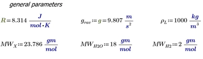

23-Emerald V
I don't know why Odesolve can't find a solution to your new setup. All I can guess is that you've modified the formulae such that an unsolvable or highly unstable situation is created. Some remarks:
- You define at the top:
Then what do all these constants 9.81 in the formulae? And did you know that g (by itself) is a predefined constant in Prime?
Ah, the predefined g has units, and you work without units. You can define your variable g.rav := g/SIUnitsOf(g).

Why your calculation without units? Must be so! More easy for understanting ans debuging!
23-Emerald V
I can answer that question. There are two reasons:
  1. The symbol gm that you use is not an official unit. The official unit for gram is g (in roman font).
  2. The OP's mathematical model uses fractional powers. Prime is not good with units and fractional powers.
1. g:=gm with lable units. But g is one unit too - unit of accelation. Or one constant.  g=kg/1000 and g=9.8 m/s^2
2. Show please an example! if one formula can not use units - it is not quit correct formula! Me must correct it for units. One empirical formula for example!
