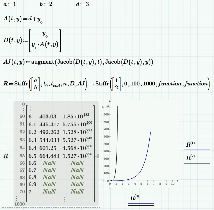

I have a question about Mathcad. I want to solve an ODE-system with Parameters. I want to use of Stiffr or Stiffb as a ODE-Solver. I have a minimal example in the file. See also the screenshot. What can i do, to find the error in the code?
I hope someone can help. Thanks

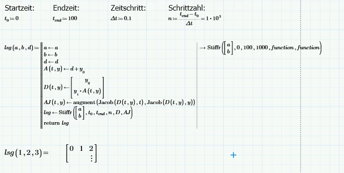

I found a solution. The post helps me a lot:
https://community.ptc.com/t5/PTC-Mathcad-Questions/Solving-of-ODE-with-variable-parameter/td-p/43366
The problem was the Jacob matrix. Is there a solution without programming? Is this possible?
Now my solution looks like that

It looks to me that you don't use any programming structures anyway. So what you do inside your "program" "lsg" you could as well do directly on worksheet level.
fgörlich1-VisitorAuthor
February 25, 2018
And how do you do that? I had try different solution but only that works.

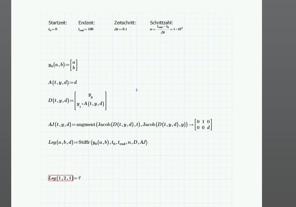

Here is the file,
can I write it without the programming part?

March 2, 2018
@fgörlich wrote:
Here is the file,
Yes, but are you sure about the correctness of the result. The values in the last column quickly exceed  Primes numeric limit (around 10^307) and so just get NaN's .
Without the symbolic evaluation we get an unknown error and I have no clue what the sybolic eval does and why its presence is necessary to get a numeric result.
