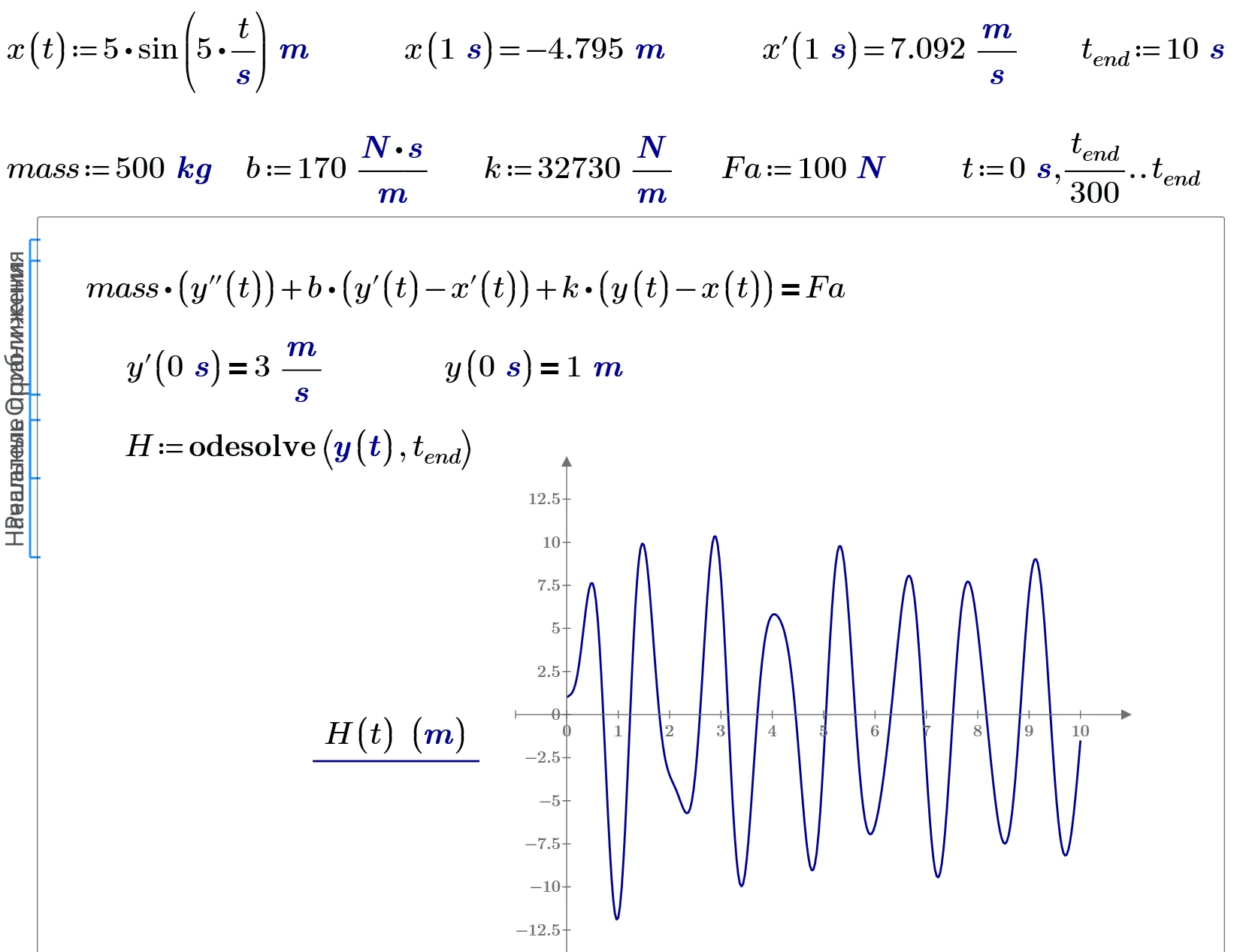

Hey,
I am trying to model the second order differential equations for the shock absorber. I would like to get the funtion of the movement of the mass. I am getting errors from the Solve Block in MathCAD, and I cannot understand where is it coming from. I suppose the reason is the sin function x(t), but I have no idea how can I write it differently. Without units the solver was working fine, but with units I get always an error. I am uploading the MathCAD file.
I would be glad for some hints and tipps! Any help is welcome! Smiley Happy
Best regards,
Jolanta

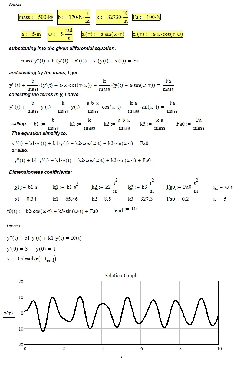

ValeryOchkov, thank you for your answer Heart It is veeery helpful, I was stuck with it for many hours...
But can you elaborate it a little bit, for example why should I write it like this:
I do not get this t over s 🙂
Thanks!

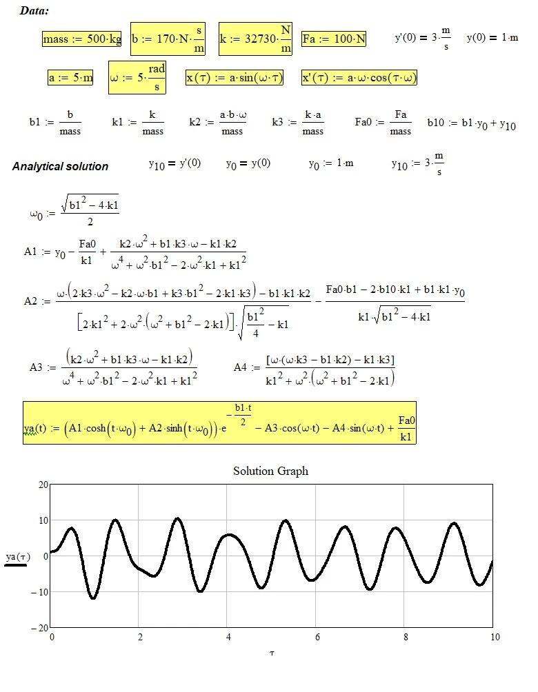

May 13, 2018
Hi JolantaPers,
es ist so einfach....
