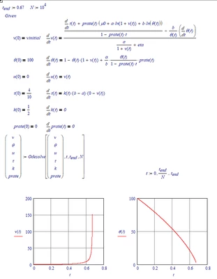

I have two ode's that have a parameter. When I set the parameter to zero some (but not all) the solvers give results that might be reasonable. But, if I make that parameter a very small number, none of the solvers work even though this would not seem to make the equations parthological. Does anyone have some insight to what is going on?

I get to t=0.67. :
for higher values of tend, the error message is: "Found a number with magnitude greater than 10^307 while trying to evaluate this expression". I guess it's related to v(t) running skyhigh
What is the 0 doing in your expression for dTau; should it be Theta? Not that it helps, though: With Theta in that position, I get a solution only up to t=0.1.

Thanks. That was helpful. I anticipated spikes, but not so early. I should have investigated shorter time intervals. With AdamsBDF I get up to 0.8 although all the other solvers fail. Increasing eta which is a kind of damping parameter might help. I haven't looked at this yet but I cannot make it unrealistically large. I do not get a helpful error message like you did. The ones I get are different and less helpful: "this value must be real," "the return value of the function must match the problem size", "this problem does not converge to a solution". A difference between MC 11 and MC 14? I remember that we communicated about this before.
The zero in dtau should be there. I modified the worksheet from one that looks at a different case. Instead of eliminating the number that went into there, I just made it zero.
Just case you are interested, the equations describe a spring block model that uses a particular type of friction that has been documented in many experiments on rocks. The friction depends on the velocity v and a state variable theta that reflects the evolving characteristics of the friction surface. The spikes correspond to model earthquakes.
