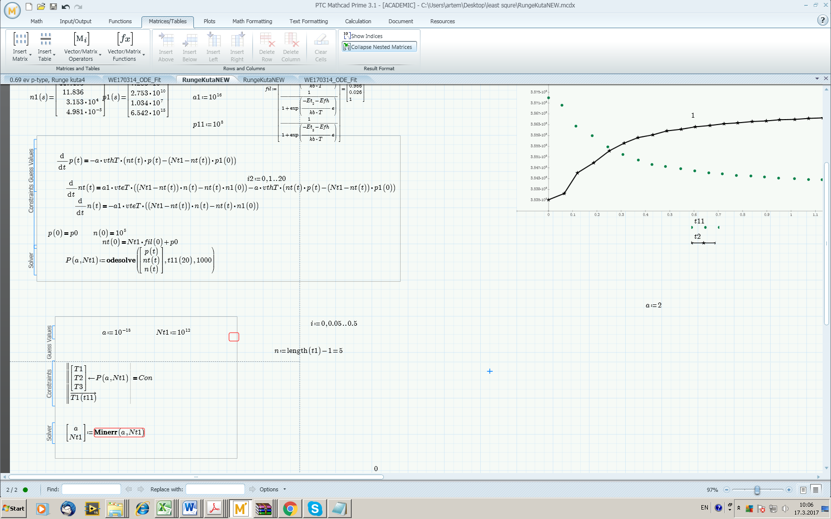

I am trying to find parameters of the set of differential equations. So, I solve st of dif equations by Odesolve (see attacehed) and then trying to minner coefficients a and Nt1 using experimental data Con and t11.
The system must at least work, but I have error at Minerr step. Could someone help me with this? Thank you, very much.

I have noticed errors in the first solve block so far. Variables Nt1 and a are not defined. Further calculation does not make sense.
Viktor
The solution of ODESOLVE is a func of NT1 and a. So FAR this values can be given further.
