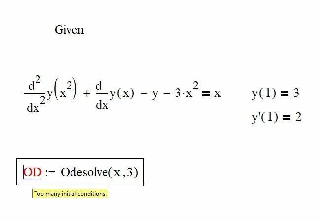

You wrote "y" where you should have written "y(x)"
Do you really mean y(x^2) in the second derivative and not just y(x)?
Mathcad does fine with y(x)

Thank you very much. You are very helpful, This is my second day learning mathcad.
For the second derivative it is y"(x^2). I don't understand either. Can you give me a reason for this?

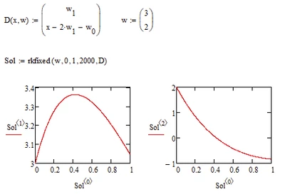

In your MC15 file you will have to define D as a function of x and w and not of v and w.

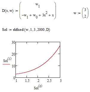

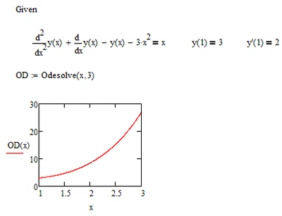

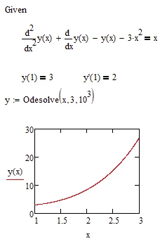

But you are solving a quite different ODE (system) using rkfixed compared to the one with odesolve
To solve the same ODE with rkfixed as with odesolve, you would do like this:
Note that you don't need to define a range for x!
