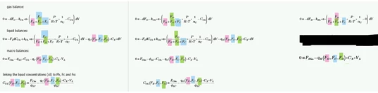

Hi everyone,
As a chemical engineering student, I am trying to solve a pipeloop problem.
I stated all the necessary balances (see below):
And the other necessary formulas:
which I want to solve for Fh(v),Fo(v) and Fc(v) from v=0 until v=VL.
now I've set up this solve block:
which in theory seems solvable, as there are 5 unknowns and 5 equations.
Is this the correct way to solve this problem?

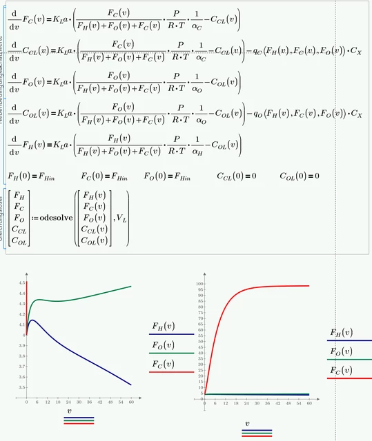

Werner_EAnswer
Dec 15, 2022 3:04 PM UTC
You have a couple of errors.
The functions you are looking for are functions in just one variable (v) but you sometimes used them as if they were functions in three variables.
Sometimes you simply wrote F.C (as if it were a simple variable) instead of F.C(...)
In the IC you had a typo and wrote C.CL twice and were missing C.OL
You have to solve for ALL unknown functions even if you are not interested in C.CL and C.OL
This should help (worksheet attached):

Werner_E25-Diamond IAnswer
