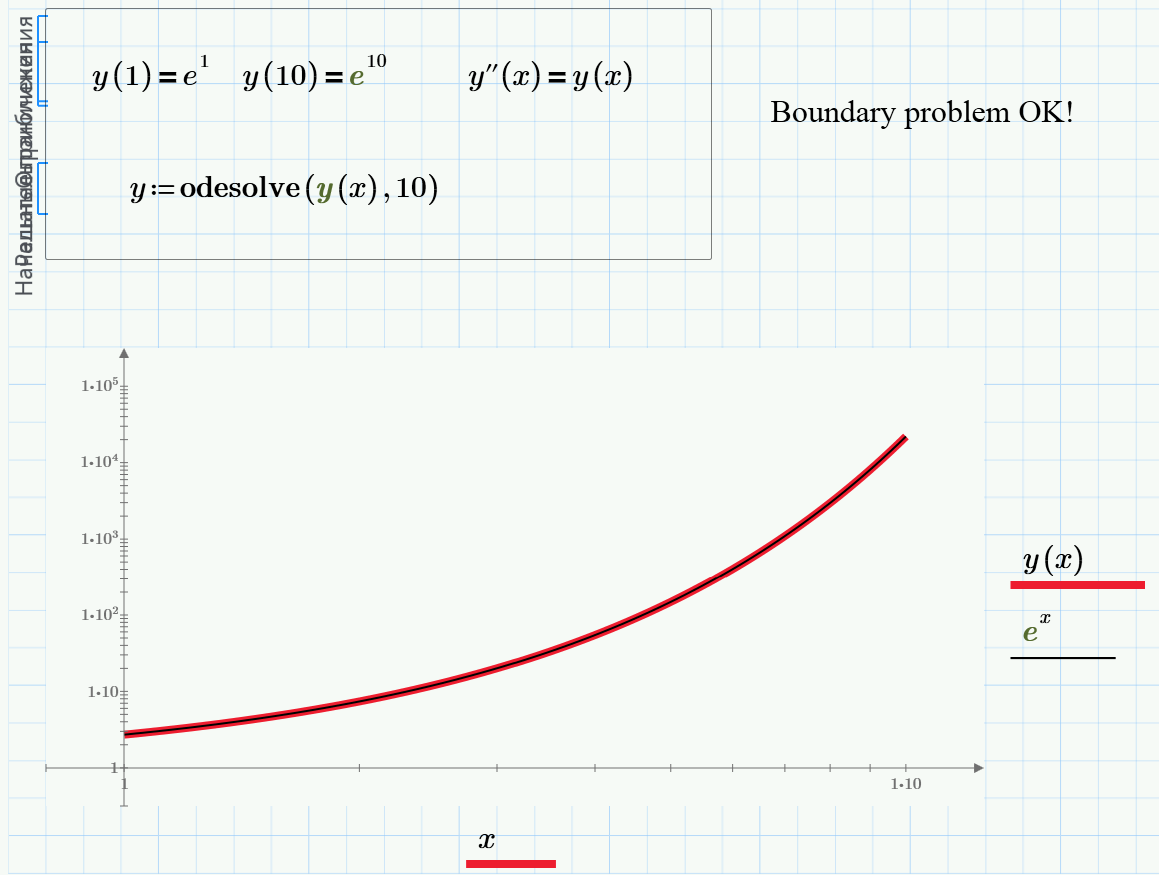

I was surprised (and pleased) to discover this, but it only works sometimes.
An attempt to impose a constraint inside the solution range fails.

Mar 11, 2015 4:38 PM UTC
It looks like you have circular definitions of v and y for the cases with errors.
Mar 14, 2015 5:15 AM UTC
I was wrong about the circular definitions...it works. You need to replace the independent variables in the odesolve call from t to x to agree with the rest of the problem. Both of the problems with errors work fine then.
Already answered.....hmmm?
Mar 14, 2015 5:55 AM UTC
Thanks, Harvey.
It was my error.

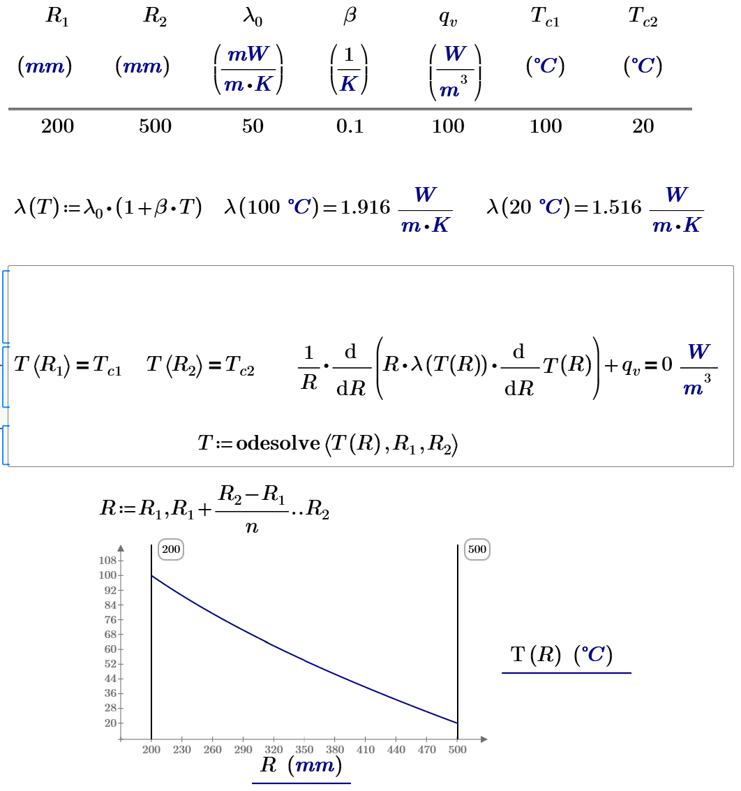

Mar 14, 2015 6:22 AM UTC
It is my odesolve (the temperature field in circular wall at static condition):
