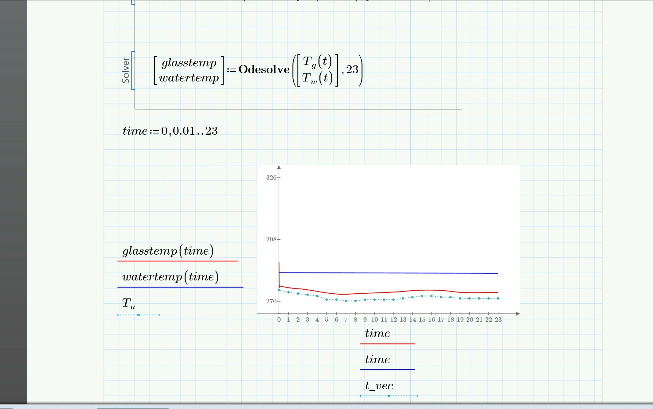

Not a straight line
Did you run everything as is? Now I am wondering if it is just the version of MathCad I am using. I am using the software we have on our university PC's. This is what I get when using the university software.
I hope you get the picture on the screen facing in the right direction as  I could imagine that it would be quite tedious and exhausting to use the computer in the headstand. 😀
Take a second look at Valerys picture - especially note the scale on the vertical axis!!
watertemp is decreasing, but very very slightly.
