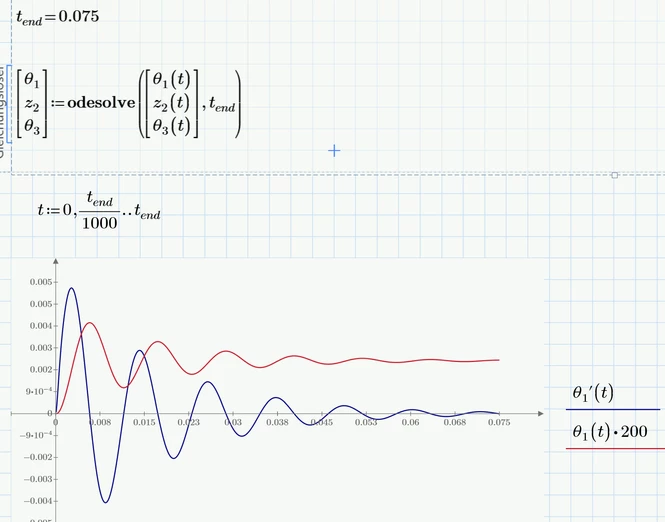

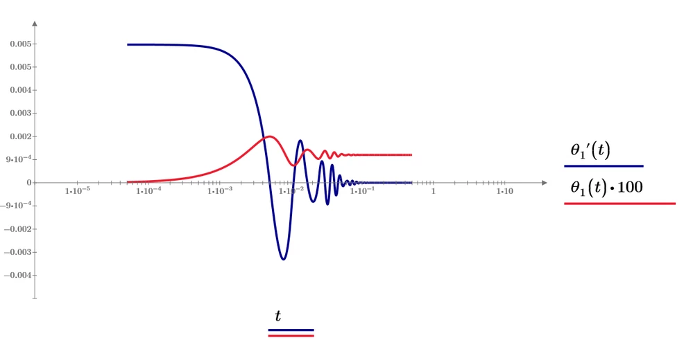

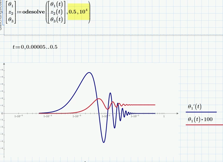

Theta1' doesn't start from 0. ???  So still it has some error.
t.t.
Oct 18, 2023 2:29 PM UTC
No, no error - just numerical inaccuracies.
Adjust the end value (75 -> 0.5) and you may also increase the number of intervals from default 10^3 to something larger:
I guess the 75 originally were meant to be milliseconds.
Here without a log-scaled abscissa:
