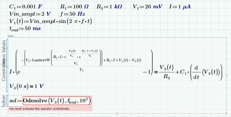

The Lambert W function is not defined numerically in Prime. There exist (numerical) approximation functions for it, but I doubt if they will bring you closer to a solution for your DE.
23-Emerald V
May 29, 2024 1:21 PM UTC
Correct. That is because your DE contains the Lambert W function.
I doubt that you will find a symbolic solution to your DE though.
Cornel19-TanzaniteAuthor
May 29, 2024 1:22 PM UTC
I do not want to find a symbolic solution, but instead a numeric one
