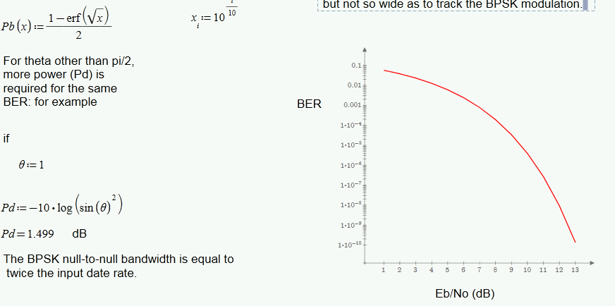

Mathcad 15 can read your file (updated copy attached) and a few editorial changes lets it run.
Prime (any version) needs a full version of 15 installed and working to convert a file forward (from 15 to Prime.) Conversion backwards is not available!
So, yes, you can bring your sheet forward into Prime, and if the error function ("erf") isn't too advanced for it the free version will run it.
You can also have a free 30 day trial of version 15, so you can theoretically bring the sheet into Prime.
Why don't you try just entering the equations in Prime to see if they work. (I'm assuming that there's more to your sheet than what you attached or this approach would be obvious.)
Good luck!

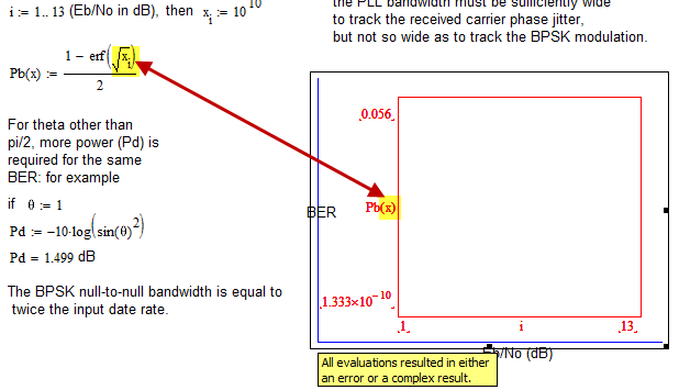

Concerning the sheet you attached, I hardly can believe hat it worked OK that way in Mathcad 7.
At least Mathcad 15 chokes on it as of the wrong usage of the range i.
It can easily be repaired by exchanging X[i in the function definition and x in the function call as shown in the pic above.

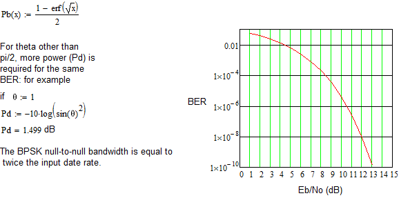

This file is simple enough and converts OK to Prime. You will just have to reposition some of the regions. Of course you will have to live with Primes limitations, e.g. there is no grid available in a plot.
Unfortunately the file will not work in Express because erf() is considered a premium function.3.png
File in Prime3 format attached. When you open it in Express you should the the plot because Prime does not recalculates when a file is opened but just shows the last results. But as soon as you force a recalculation, either by typing CTRL-F9 or by changing a value which forces a recalc, the plotting will fail with a meaningless error message but the reason is that the error function is locked in Express.
