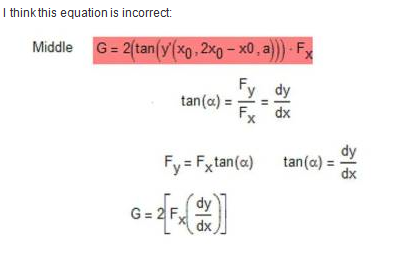

Fred said:
I agree. It would only be correct if Fx were the tension in the cable, but then some other equations would be wrong (though your equation above still has mismatched units Fred!).
Alan
November 6, 2013
I should have added that the "this equation" to which Fred is referring is:
Alan
November 6, 2013
Sorry
g*G

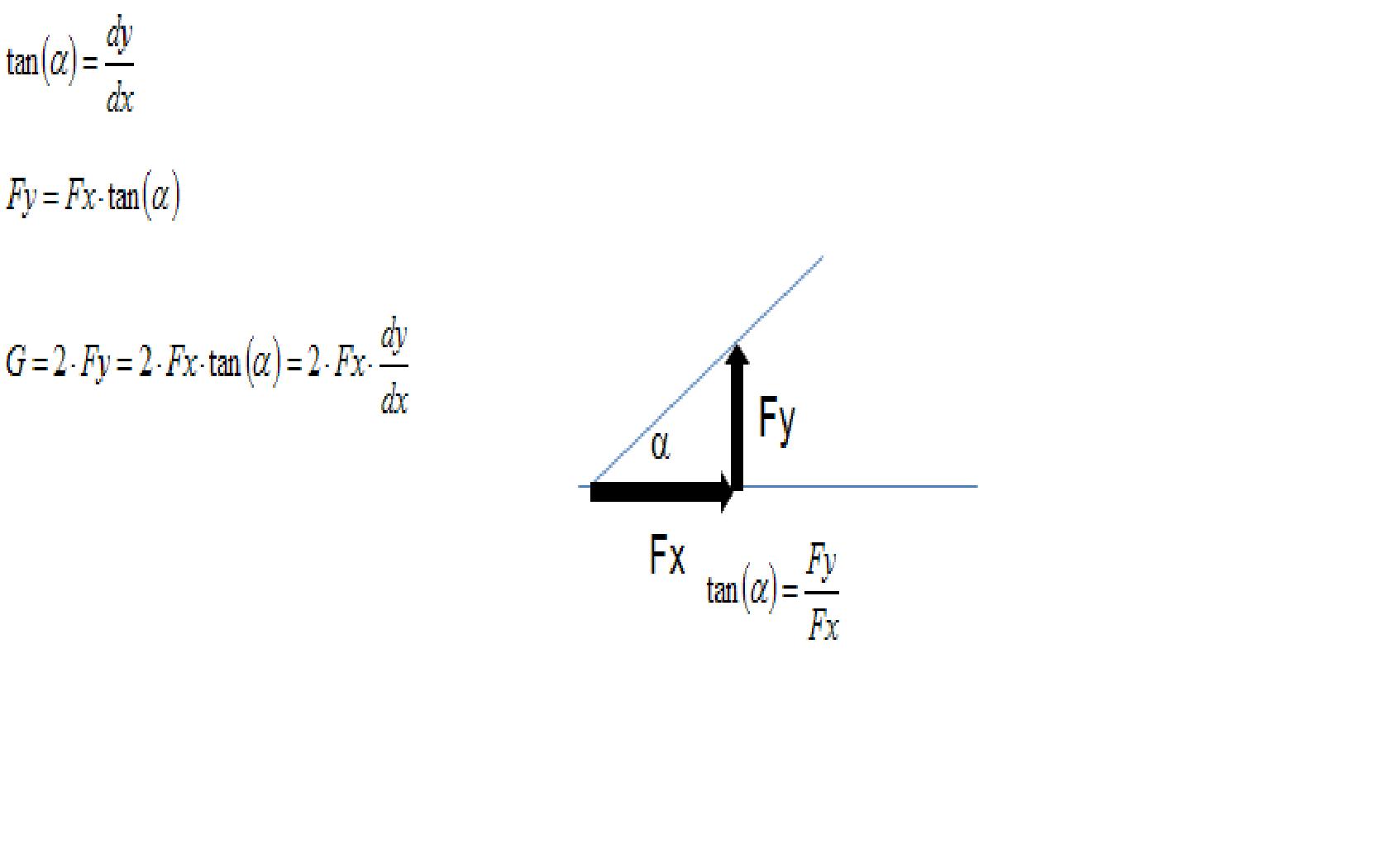

Not tension, only the horizontal component:
Sorry, my image didn't come thru well. alpha is the angle of the tangent to the chain at the weight,
tangent of aplha is equal to the slope (dy/dx) AND the ratio of vertical tension to horizontal tension. If the weight G is shared equally (only at the midpoint) then the math follows.equations.JPG
23-Emerald I
November 6, 2013
I'll leave the animation to others; but I think this is the full solution.
