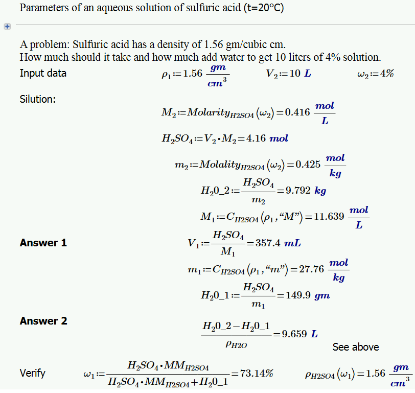

VValeryOchkov24-Ruby IV13 years agoApr 16, 2013 11:11 AM UTCQuestionOne chemical problem with Mathcad Template0 replies1374 viewsTranslate AllChemical_Engineering
