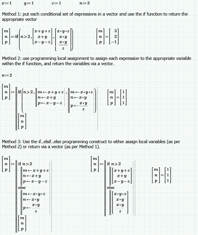

How to solve for multiple variable with one condition?
for example: how to solve this problem using mathcad program, I use mathcad prime 3.0
if n>2
m=x+y+z
n=x+y
p=x-y-z
else
m=x*y*z
n=x*y
p=x*y/z
I know how to solve one variable with multiple conditions using "if condition" in Mathcad. i.e
m=if n>2 then.........if else.........else............
In this example I have accommodated few conditions for one variable. But in above program, there is one condition for few variables. and I don't want to use separate "if conditions" for each of the variable. I want to use one condition for each variable in one formula/block, if possible.

Something like this?

Thanks Fred
It helped me.

... or use Fred's functional version of Method 3!
