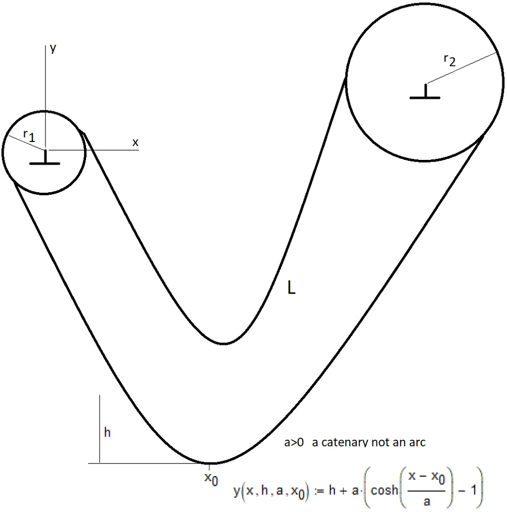

(Bicycle) chain is slung over two blocks.
Given: r1, r2, x2, y2 (x1=y1=0) and L.
Find: a form of the chain.
Слабо?
If r1 and r2  -> 0 (or L -> infinity) we have this problem - see here.

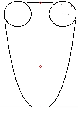

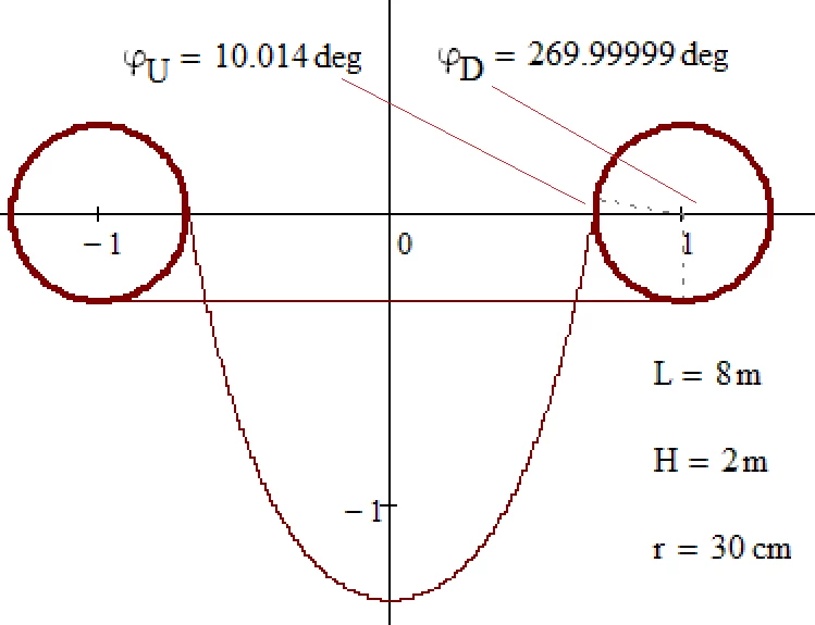

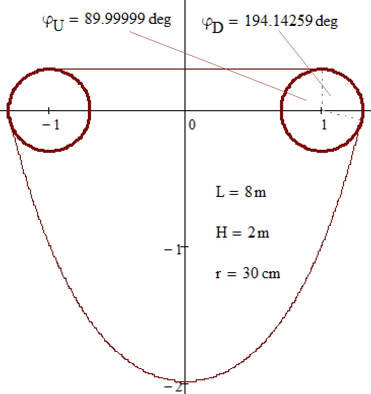

One solution at r1=r2 and y2=0 (two picture and Mathcad 15 sheet in attach).
23-Emerald I
August 30, 2018

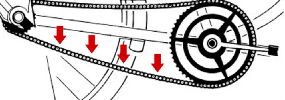

Your two pictures assume that one side (either the top or the bottom) is taunt--a straight tangent.  But bike sprockets can introduce torque (see your picture in the first post.  You can have any intermediate configuration between your two extremes.  There's another variable--sprocket torque.
August 30, 2018
Thanks Fred!
(More) correct result
