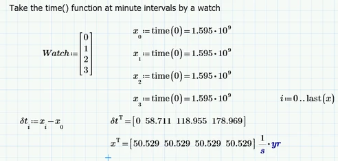

One Mathcad Prime 6 sheet and 3 question
1.
I think that time(0) sec= 50 yr is a begin COVID-19. Can you in Mathcad find this data ??.??.2019?

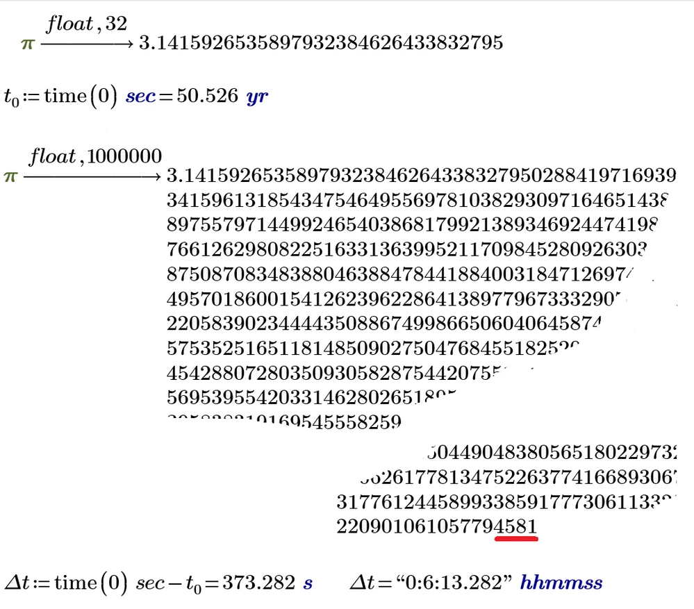

What the maximum n digits of pi we can find in Mathcad?

If I take the time(0), it gives me the number of seconds from 1/1/1970.
(EXCEL starts at 1/1/1900)
The 3-d question: Why real time of calculation is two time more?

You're getting little over 50 and a half year, which is where we ar at now, since 1970-1-1.
Recently, indications have been found that Covid-19 may have been around already since before dec 2019...
