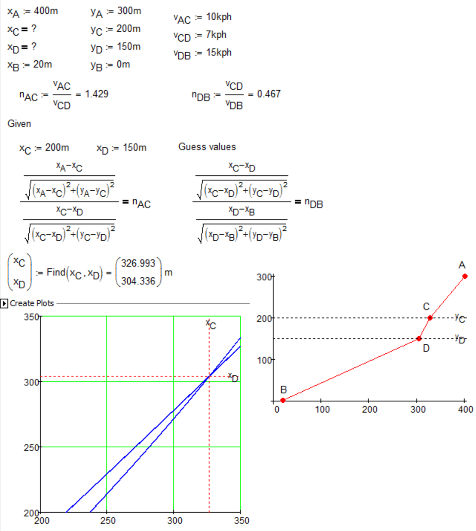

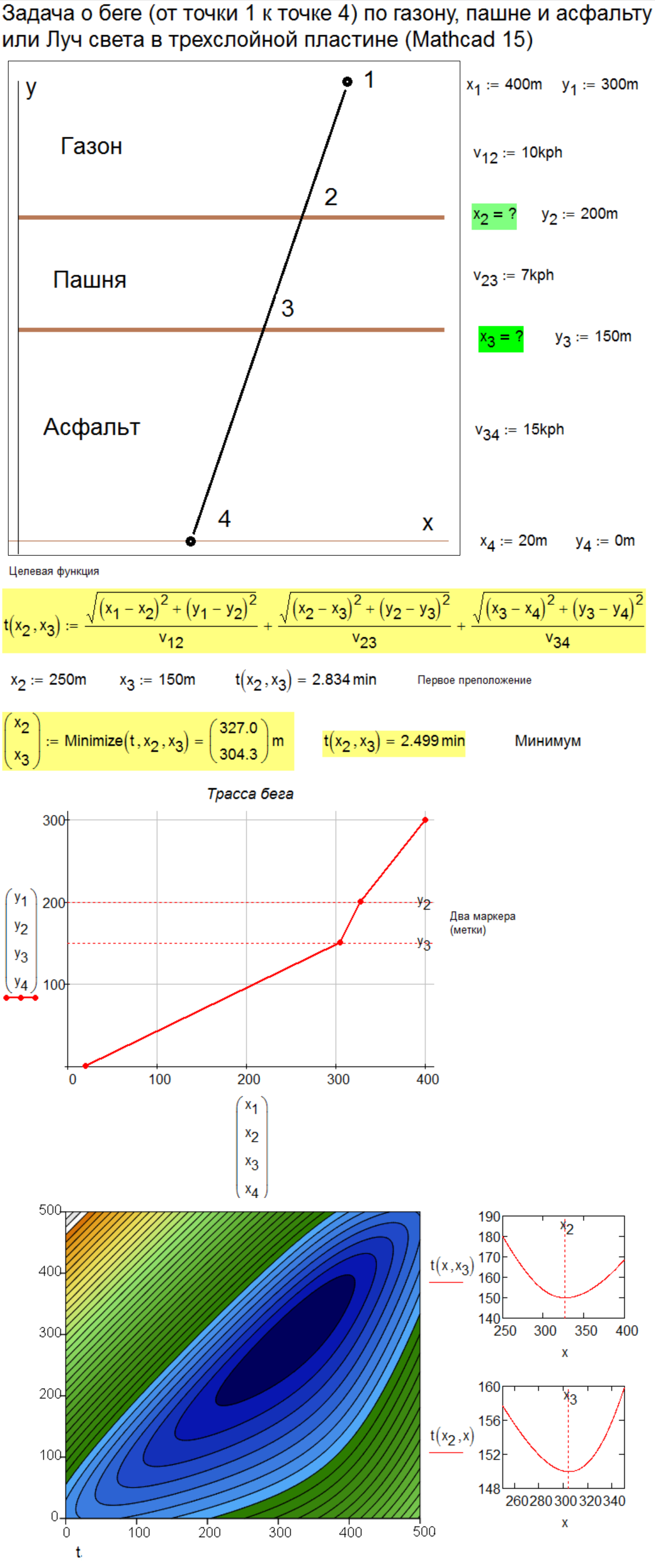

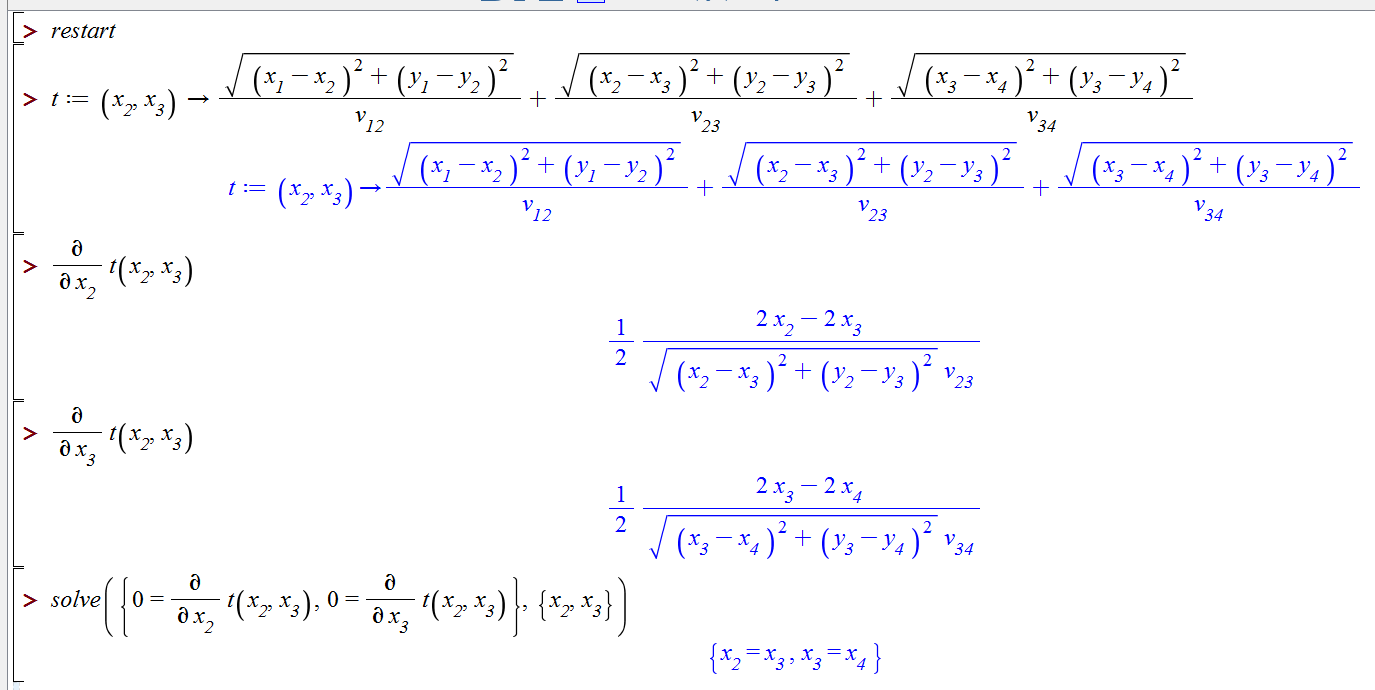

I am trieing to solve one minimize problem.

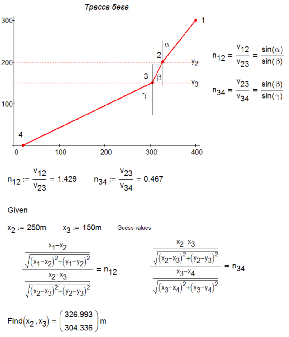

Numerical is OK - see please the picture and the Mathcad 15 sheet in attach.

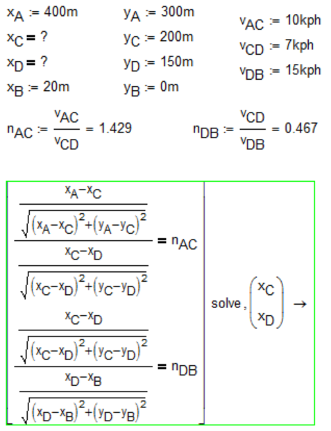

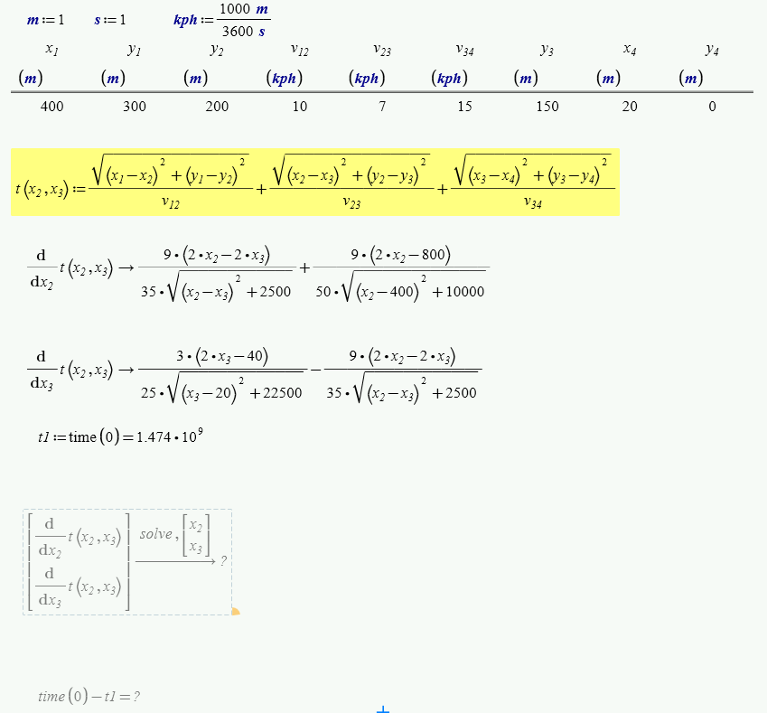

But numerical - problems - see please two sheets (15 and Prime 3.1) in attach.
Any help please.
The problem of the race (from point 1 to point 4) on the lawn, plowing and asphalt
or
A a ray of light in a three-layer plate

A try in Maple
Hi Valery.
What Maple is telling is that the critical points are the set indicated as x2=x3 and x3=x4. This is one DOF. Thus the mininum for your problem isn't a point, it is a curve given by
This is, any point at this curve its a local extrema, and a minumun if t''(u)>0, which I don't check.
Best regards.
Alvaro.

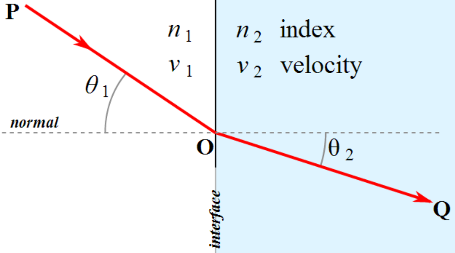

It is one optic problem.
Video Link : 7197
An optic solution of the problem
