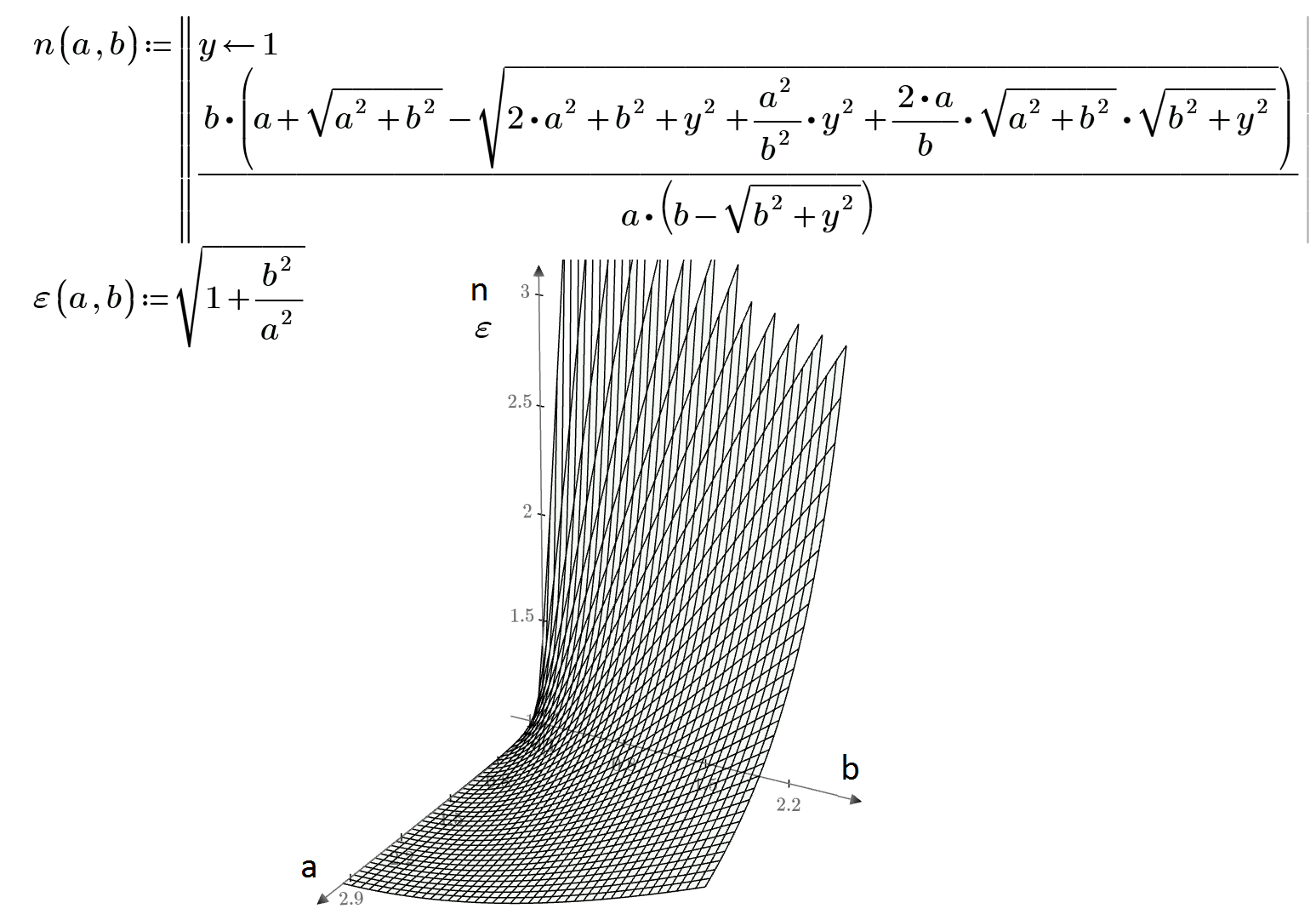

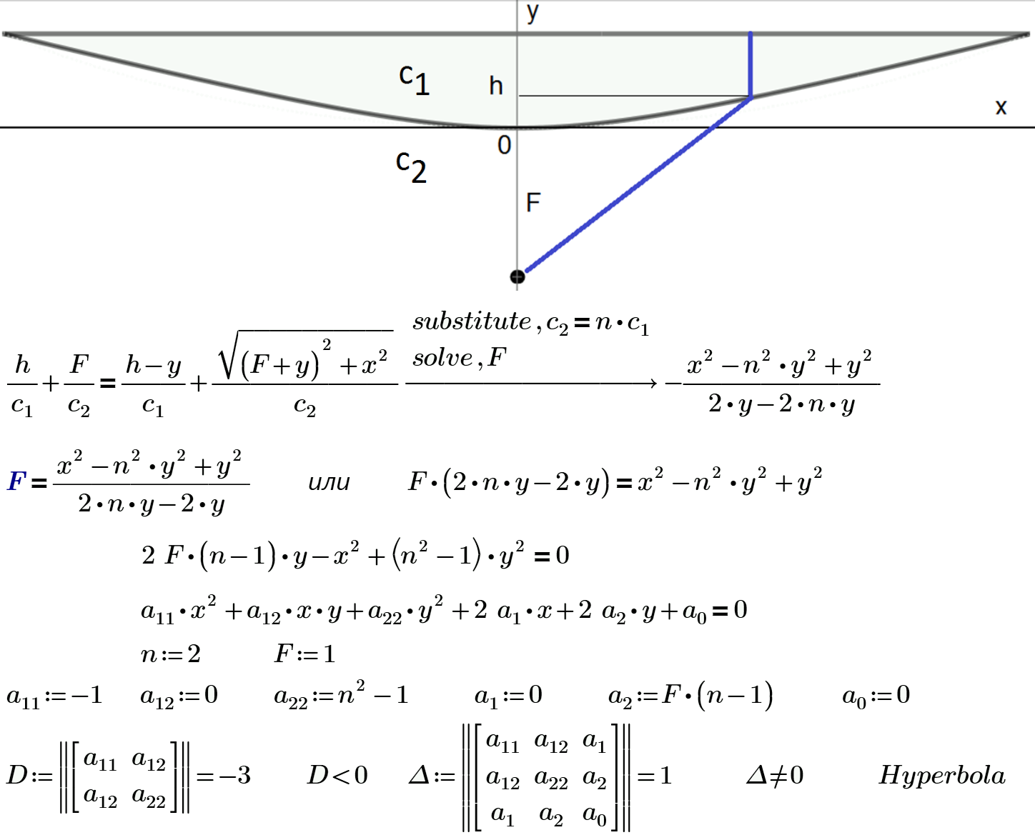

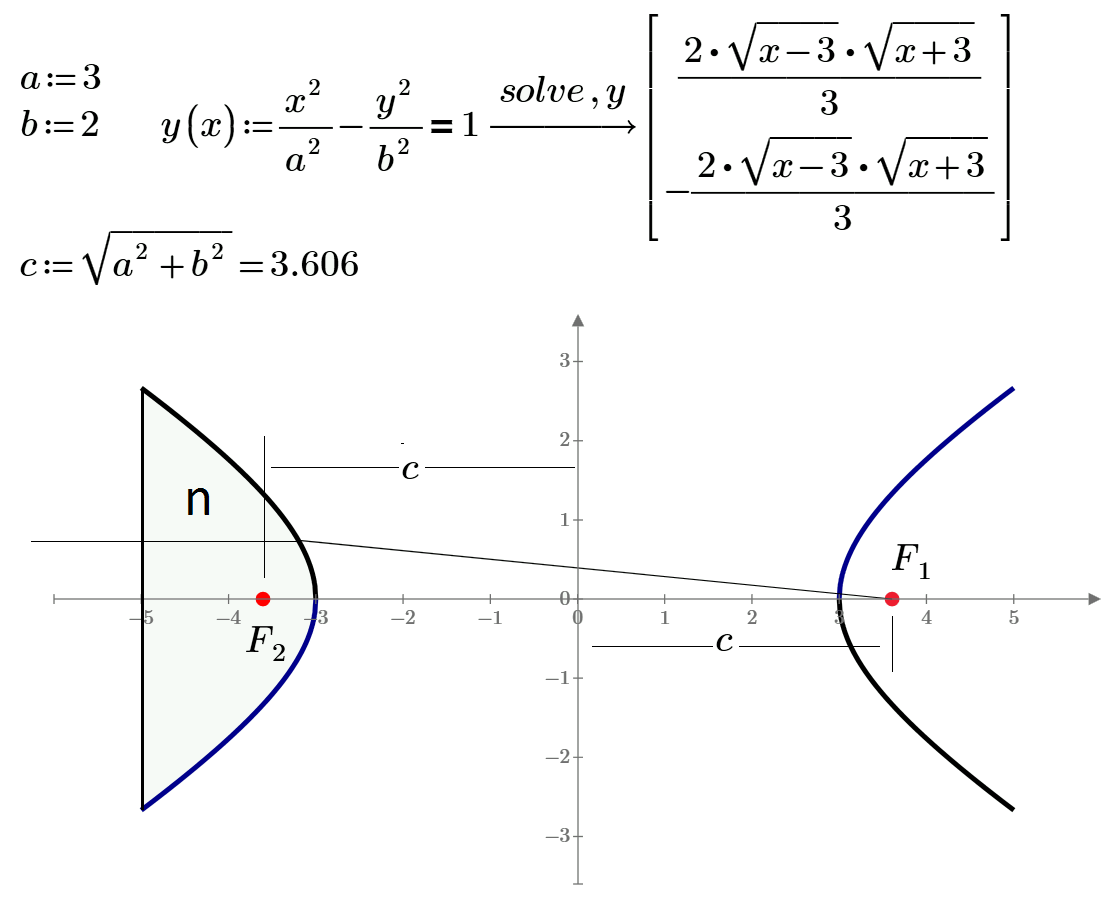

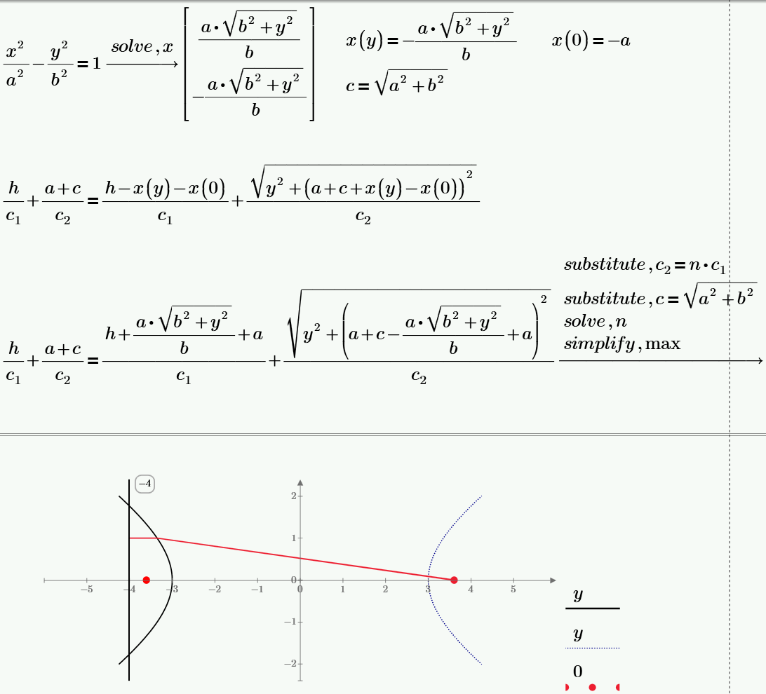

At which value n the optic focus of lens is a geometric focus too?
See please two pictures and two Prime 3.1 sheets in attach.
16 replies
Where is an error?

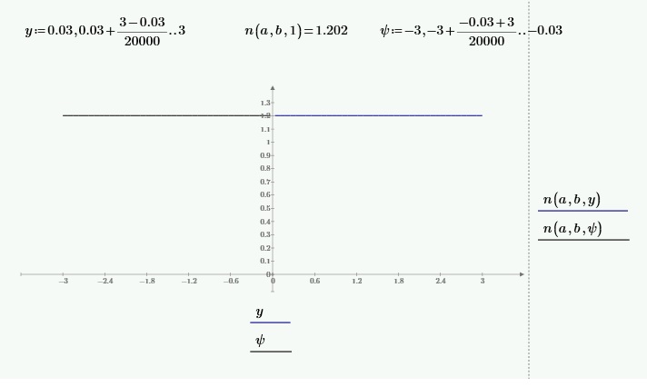

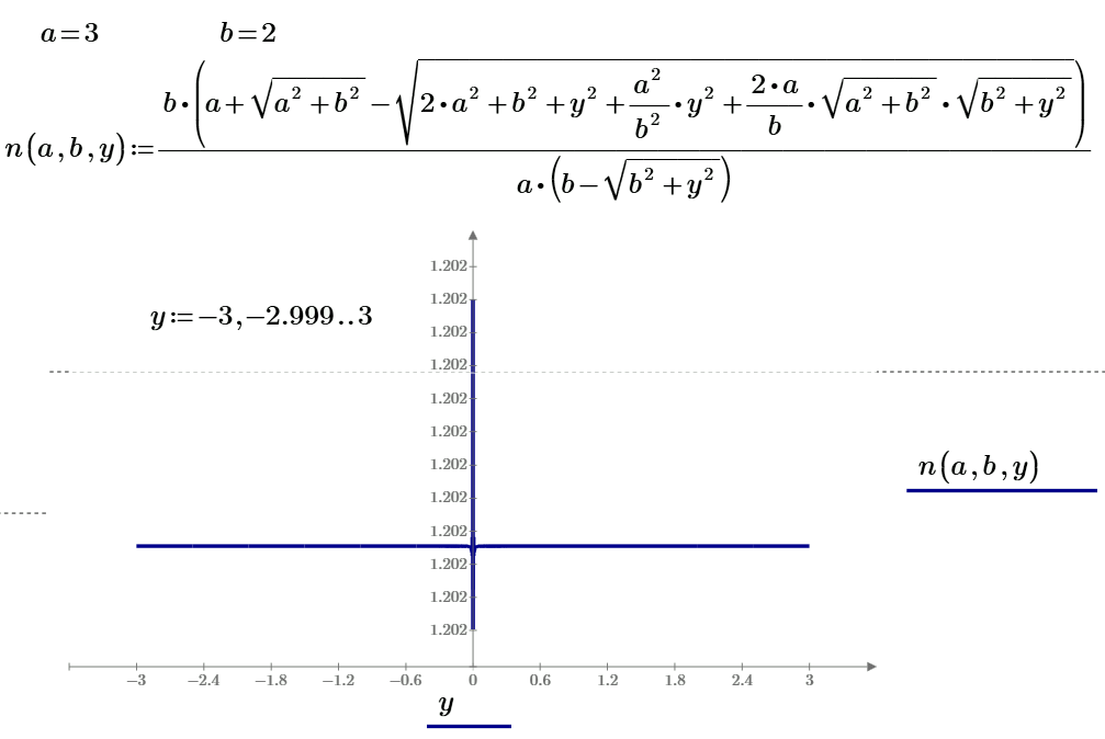

I have the function but with y as one more argument.
How can I delete y? Substitute y=1?
-MFra-
the function n (a, b, y) has a pole at y = 0. So you have to exclude the pole in order to draw a graph.
