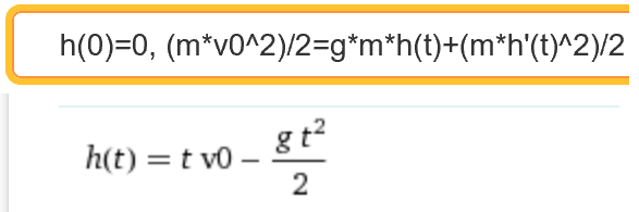

Simple solution. Зачем усложнять исходное ДУ?

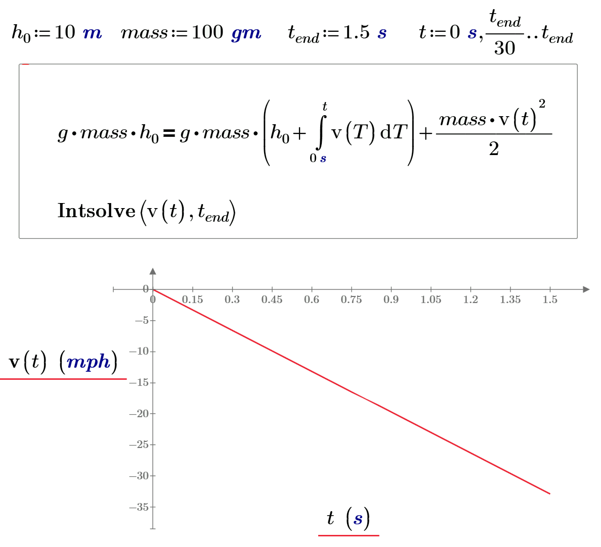

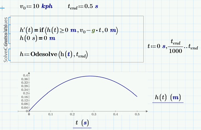

I think it's because of non linearity of the derivation of y(t).
There may not be y'(t)²- The terms of the higest derivation has to be linear. It's a typical Mathcad Problem.

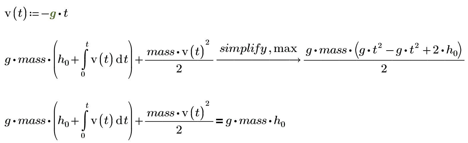

Derive the Energy-Equation to the variable t, and all will be fine.
See attachement please.

Ah, ok.
here the pdf-worksheet.

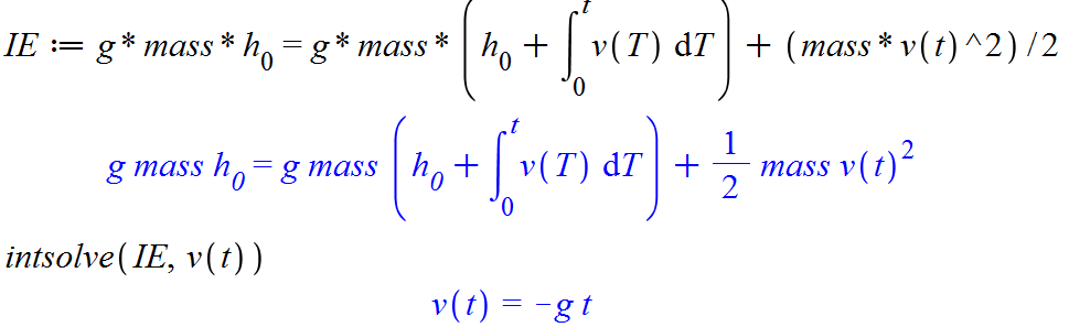

May 29, 2017
One more solution
Maple
May 29, 2017
Intsolve() is not dokumented in MP4.
How can that be?
Is it dokumented in MP3.1?
