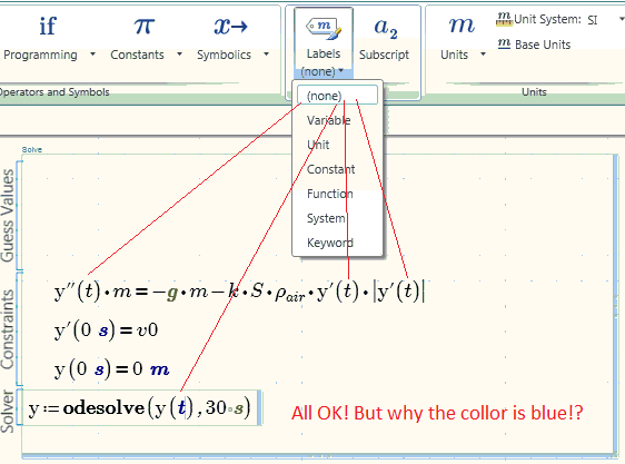

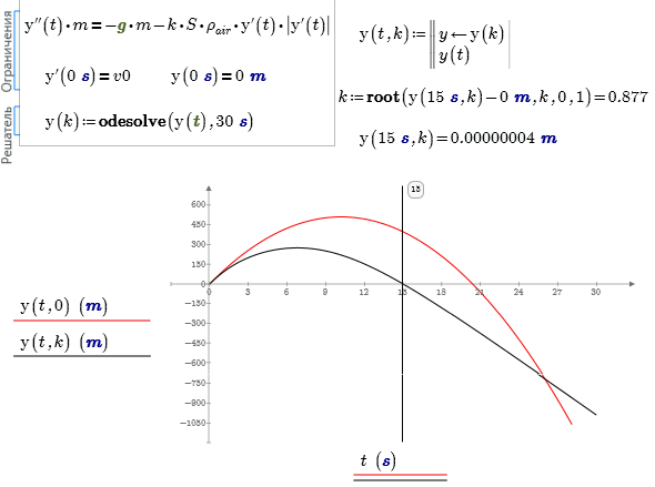

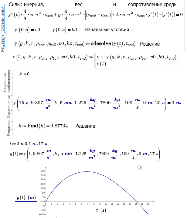

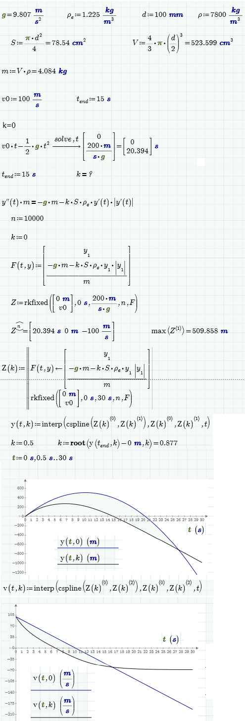

A Task.
A steel core thrown vertically upward at a speed v0 and fell to the ground in 15 seconds. What is the coefficient of air resistance in the equation Ffriction = k S Ro v ^ 2? [The answer k=0.877
I have a solution with the using the rkfixed function (Mathcad Prime with UNITS!- see the attach). In Mathcad 15 we can not use units in this task
1. Is the solution correct?
2. How can I use not rkfixed but odesolve function?
3. I'll take the other comments and suggestions gratefully!
