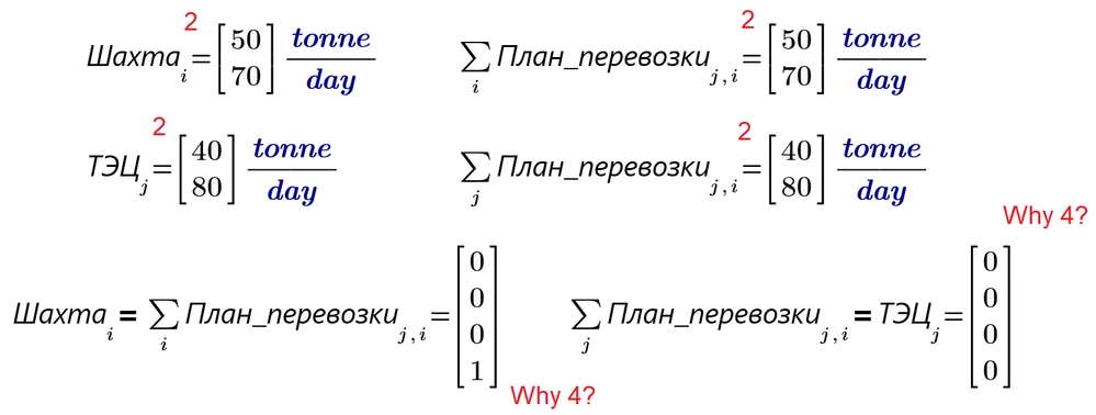

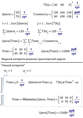

One transport problem (linear programming) in matrix form. Why?

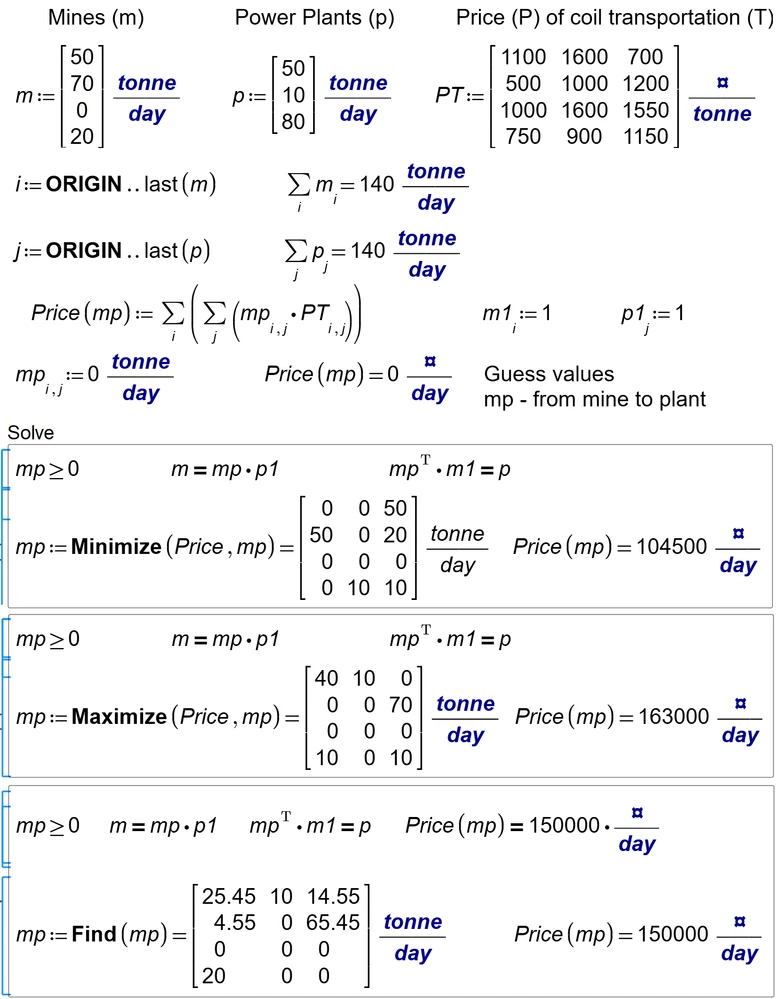

The Mathcad Prime 4 sheet in attach!
Werner_EAnswer
Of course in trhe actual sheet I would define those vectors in front of the solve block and also use a definition for the "Price" function which does not use predefined ranges:

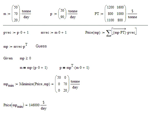

See please the sheet for Mathcad 15 but not in Matrix form.

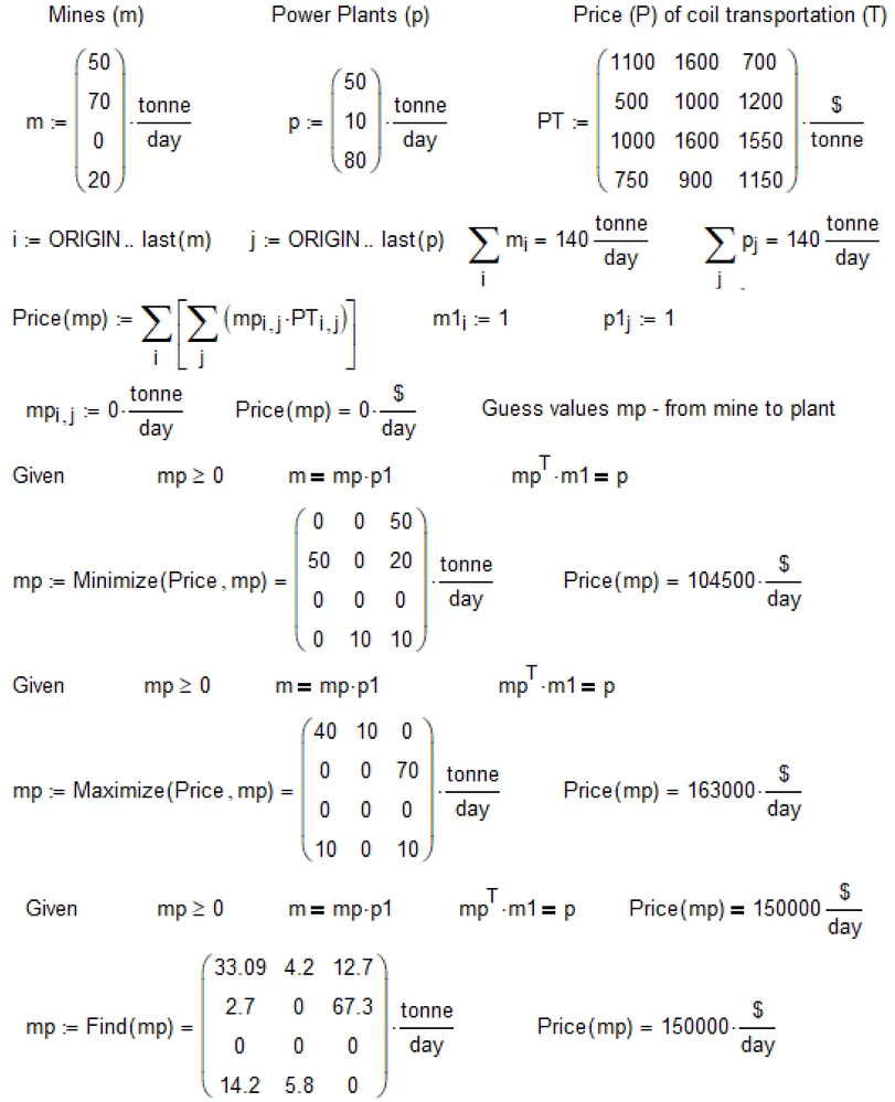

Now I am preparing the matrix form will send it late!
Mathcad 15 in matrix form in attach
Why an error?
I hope it can be one solution
Mathcad 15Mathcad 15Mathcad PrimeMathcad Prime

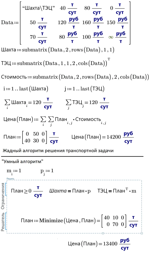

More interest form of input data. Mathcad Prime 5 in attach!
One More interest form of input data. Only with Mathcad Prime:
