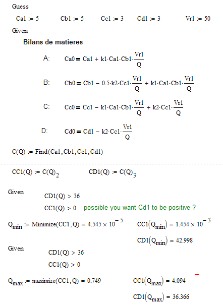

i got some  questions,  if someone would answer them, I would appreciate it very much.
well there something called nonlinear programming with constraints and also without them, i've been searching in here how to solve this type of problem but what i found wasn't exactly what i was expecting.
for example: if i want to optimise (minimize or minimize o just find a solution that fits) a variable of  a single function, a system of equations or a system of differential equations.
How can i make it?  there is a sheet attached  with the different types of problem i mentioned.
Werner_EAnswer
Would this help in case of your example 2 ?
BTW, Vrl is NOT a guess value.
EDIT: Text in the picture has a typo. Of course I assumed you want Cc1 to be postive, not Cd1 (which is > 36 anyway).
yes, it helps alot, thank you. you're right Vr1 it's not a guess value, i put it there by mistake. i have changed some things that were also wrong in the sheet. but i can't find the attach button in this chat to upload the modificated sheet.
To attach files you have to chose "Use advanced editor" at the upper right and you will be given the "attach" option at the lower right.
Here is a solution for your Example 3. Hope I understood correctly what you wanted to achieve.
I still don't understand your example 1. What should x1, x2,x3 denote? What exactly are you looking for?

thanks alvaro, for those great explanations, and btw you are so right I put the wrong constraints for the example 1.
the right ones are these:
with valery's example i could solve it, but i still don't know how to subject the system to the constraint "they cant be decimal number'.

Thanks Werner, alvaro and valery. yours solutions are ok for me. that was just to learn how to do it. i appreciate it.
Now i present to all of you the real problem i had, as alvaro said  system of diff equations is a more complicated thing to optimise. if it is so what i really had it was much more complicated, i guess. i had a final project in which i had to optimise a concentrations coming out of a system of reactor in series. i had 3 system like example2 one following the other, following the third one i had a system like example 3. In that project,final values of a reactor are the initial conditions for the next one.  but what really matter is the values coming out of the final reactor.
I explain it in the in the sheet, if it isn't clear enough, please let me know, i'll find a way to make it understandable, btw my english is not that good, im sry for that.
The sheet is attached
