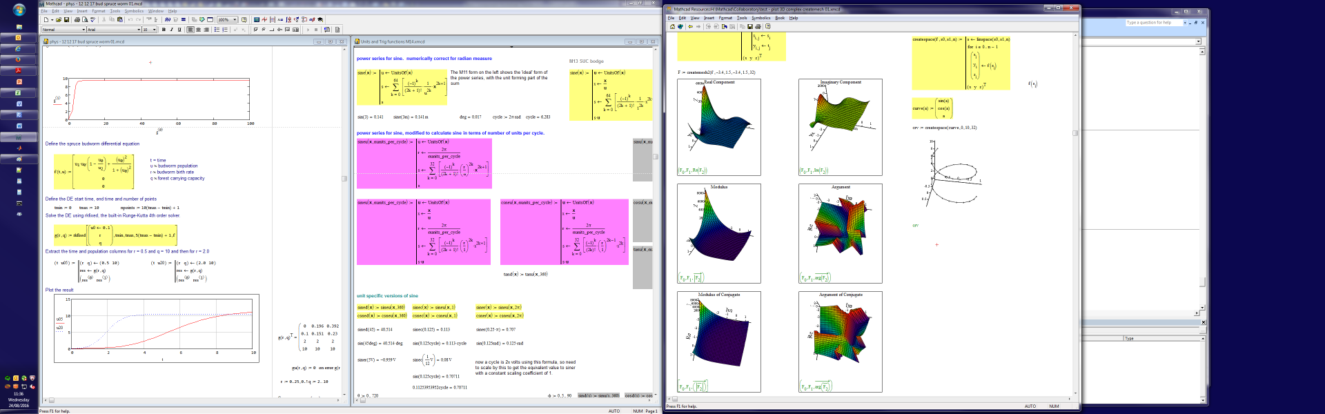

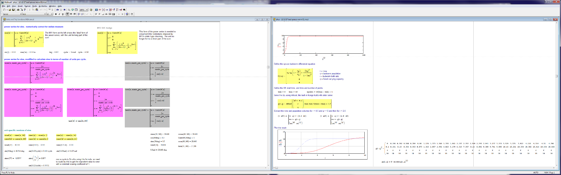

This shows two instances of Mathcad, each with two files open, at the same time.
Does this meet your requirements?

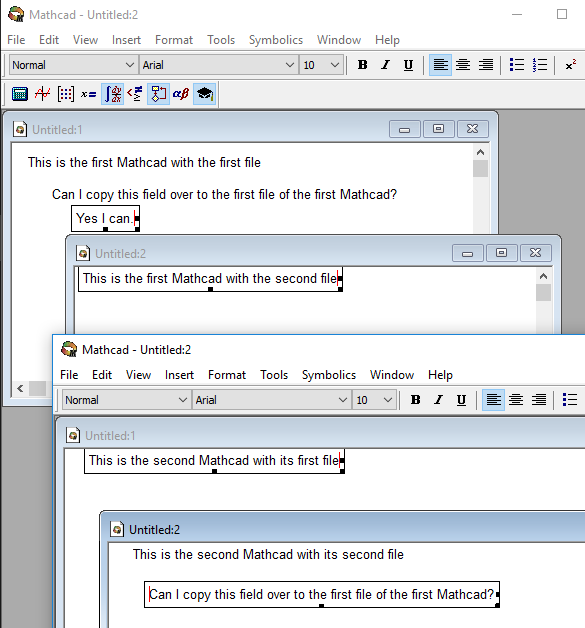

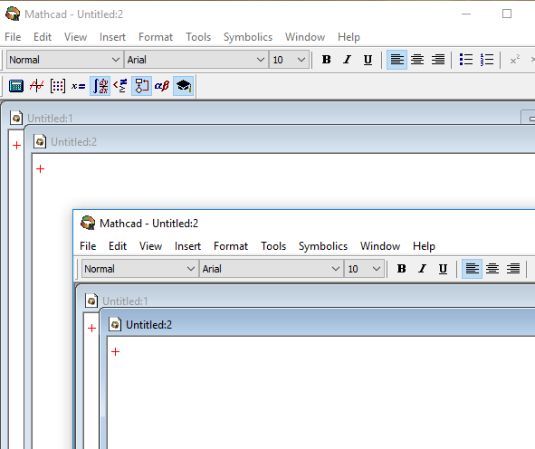

As Werner says, below: just start the Mathcad application twice, and open in each instance the file(s) you want to edit. Do not open the same file in multiple instances of Mathcad, because you risk losing the edits you made in one instance, by saving the other; if you're allowed to save at all.
My experiment worked with apparently the same files ( 'untitled1' and -2) in both instances of Mathcad, but they were new, essentially unnamed files, they weren't (yet) saved.

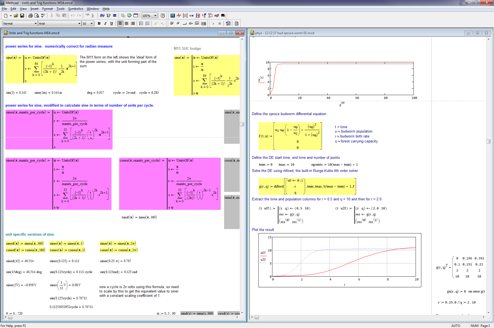

Do you mean across multiple monitors?  If so, I often use Excel and Mathcad in this way by dragging the side bar out fill both monitors (or, more usually, extend part way into the 2nd monitor so I can something else permanently up) and then adjust the windows to lie next to the "monitor gap").
Another way is to open up the Quicksheets / Tutorial / Handbook window and open a Mathcad file in that.
Stuart
