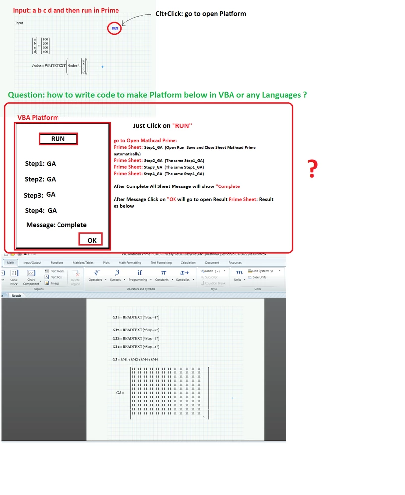

Dear all
I don't know any code or any Languages only Mathcad Prime.
Please help me my question below. My purpose is to get Platform that can order Mathcad prime sheet Open Run Save and Close automatically step by  step to get Text File without open and run manually that it hard to do with many sheets. And I also attach relevant file as below
Best regards

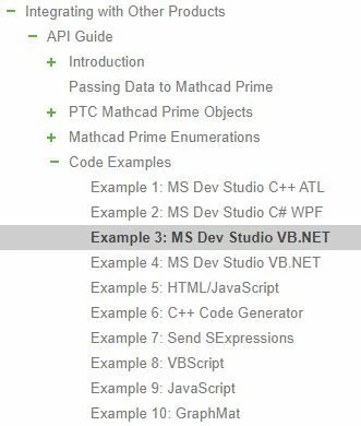

"I don't know any code or any Languages only Mathcad Prime."
Start with the example provided in the Prime help.
Example shows how to open and close Mathcad worksheets.
Cheers
Terry
terryhendicott

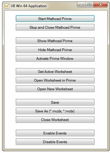

A huge learning curve is ahead.  A language needs to be chosen.
Either 1, 2, 3, or 4 is possible
1:=
An integrated development environment "IDE" is useful to program code in.
It is possible to design a form interface in this IDE
Microsoft releases a community version of its Visual Studio IDE that is free.
Language choice is C++, C#, Visual Basic.
https://visualstudio.microsoft.com/downloads/
Community
Powerful IDE, free for students, open-source contributors, and individuals
Free download
This covers examples 1 to 4 in Mathcad Help
2:=
Visual Basic for Applications "VBA" can be used to both create the form and develop coding in macros associated with Microsoft Office applications like Word, Excel, Access etc
There is no example in Mathcad help but Example 3 and 4 are close.
3:=
A free IDE for java coding is called Eclipse
It is available at
https://www.eclipse.org/downloads/packages/
Eclipse IDE for Java Developers
The essential tools for any Java developer, including a Java IDE, a Git client, XML Editor, Maven and Gradle integration
This covers example 5 and 9 in Mathcad help
4:=
With nothing but a text editor you can enter VBScript and can create a html interface.
This covers example 8 in Mathcad help.
Good Luck
Cheers

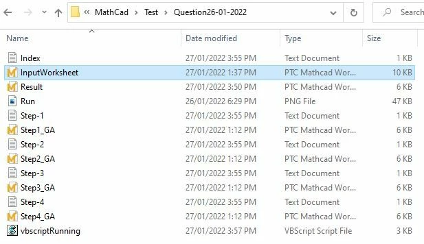

Hi
Text files should end in an extension.  I have added *.txt to all relevant files.
The problem is distilled into the simplest form with a single visual basic script that sends messages to windows.
Enclosed zip file contains all the relevant files.
Capture.JPG.

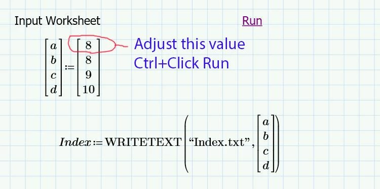

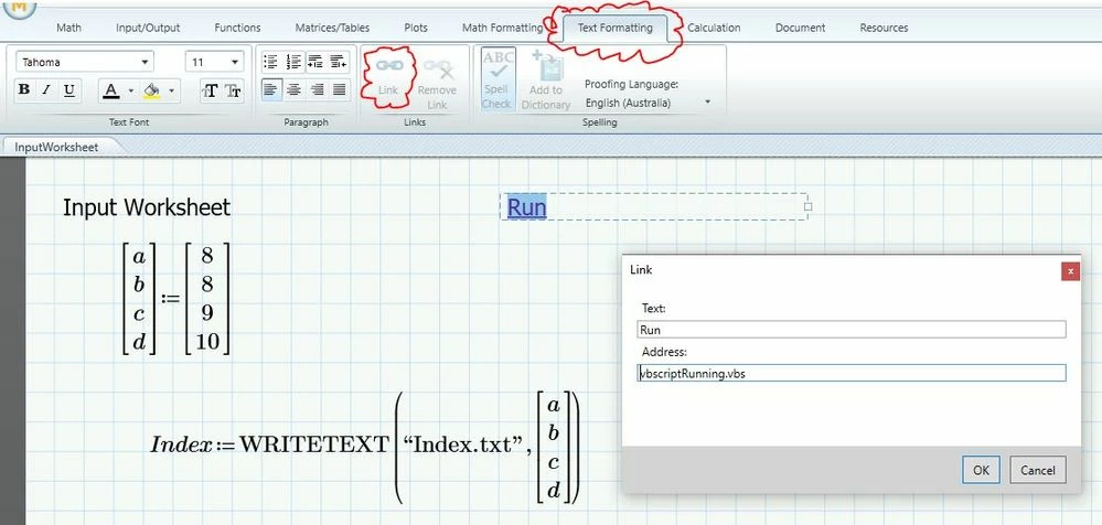

Start from Prime file "Input Worksheet", from there you  can ctrl+click on the "Run" link
Watch the messages on screen
Cheers
