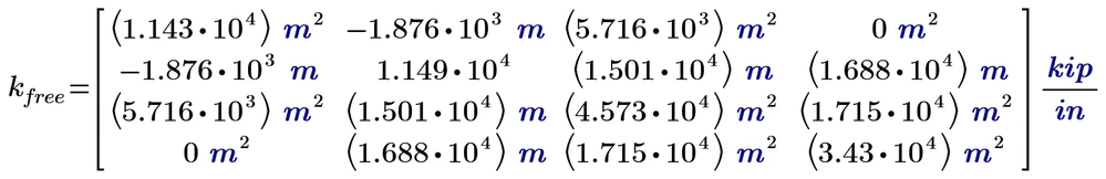

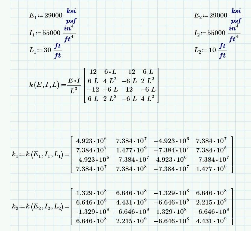

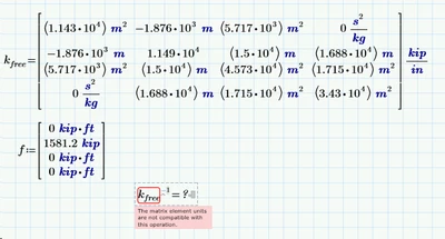

I have a stiffness matrix where units within columns and rows are inconsistent. I tried to inverse the matrix but it said " The matrix element units are not compatible with this operation". How can I fix this? If possible. Or I just did this wrong.

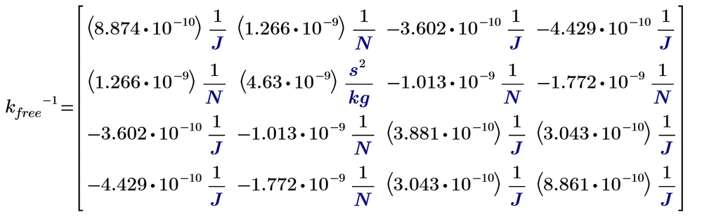

If you assign suitable units to the zero values
then your matrix k.free ends up like this
and can be inverted without errors

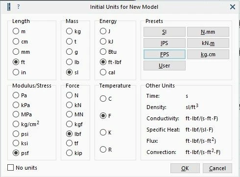

Typical structural stiffness matrices are of multiple units for various elements.  Inversion or decomposition of the matrices will result in unit inconsistent equations.
For this reason it is best to work in a consistent set of units so the value of the stiffness matrix elements are correct but without units.
A consistent set of units for imperial system is fps.  This is from a commercial software suite.
You need to divide the stiffness matrix entry values to these consistent units.

Oct 24, 2023 4:43 AM UTC
