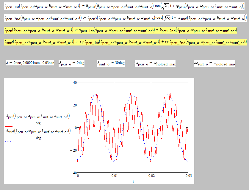

I created a set of equations that calculates the positions of the two masses with a couple of springs: one to the ground and another between them.  The result looks reasonable as it shows below:

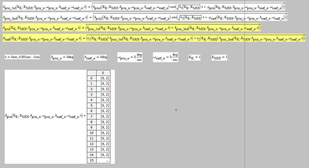

Now I am actually performing a tolerance analysis and there are 18 different conditions in a 9x2 matrix.  I vectorized all statements and got as far as it shows below:

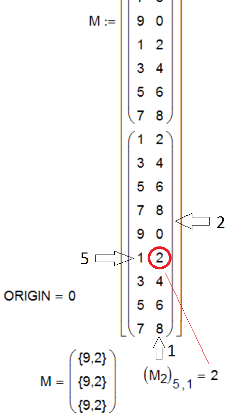

Rightfully so, each element in the vector has 9x2 matrix nested.  How do I access a particular vector corresponding to a condition?  For example, how do I plot one vector or all vectors?

For example, I want to use the first condition [0,0 in the 9x2 matrix.
I need to get the [0,0 element from the 9x2 matrix at each 0.001 sec time increment or at every index of the resulting vector.  It almost then sounds like I need to do a looping on it.
Is that right?
