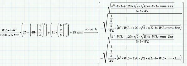

Hi
Please help me to find the h value using operator and solve h. I got 4 answers . How can I select the absolute value from the answers.

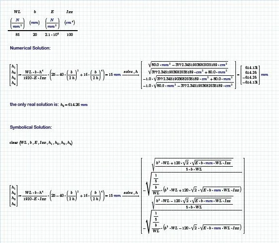

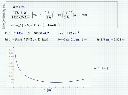

 Fortunately simply enlarging the guess value seems to cure it here, too:Pic3.png

@ldante wrote:
Hi
Four solutions seem OK for me for that equation. How many solutions did you expect?
And what do you mean by "select absolute value from the answers"?
Do you mean how to select the postive of the four (if there is any or only one).
Answer: You cant, as we don't know anything about the other variables WL, b, E, Ixx, mm in use. They could be positive, negative, non-real and all that would change the output. Also the relatives magnitudes of the variables matter. So Prime can't decide, which of the four solutions is postive or even real.

July 10, 2017
Hi Idante,
To get absolute values you must define all variables for instance E:=2.1*10^5N/mm², etc.
Then we have four solutions which must be discussed according to clarify what result is practicable and realistic.
What you found is a complete symbolic solution with four results for an equation of 4th degree.
Hope the attachement helps.
