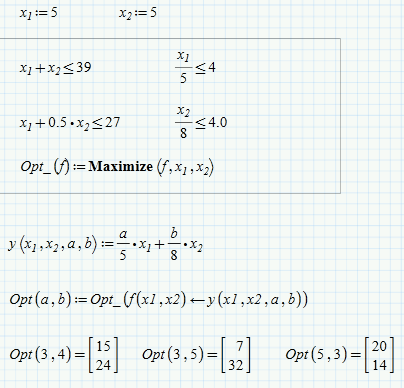

I was able to do this in 15 very easily, and that file is attached. However, I was unable to get the routine to work in Prime (unsurprisingly). As my university has removed the old mathcad program (and it will be dropped from support before long according to PTC) I was trying to atleast understand how to get the answer in Prime.
I'm afraid the way in my earlier post of using a programming block didn't work as expected, and thus I'm unsure how to be able to get the maximum or minimum of an objective function in terms of varying parameters WITH constraints given that can over define the problem.

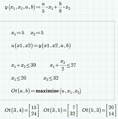

Nov 21, 2014 5:44 PM UTC
Its a shame that they have broken in Prime the way we could have easily done this in Mathcad.
You are right, the method given here http://communities.ptc.com/message/263632#263632 does not work because you have constraints and so we need to use a solve block. On the other hand, the function to be maximized (the auxiliary function with just two arguments) changes dynamically depending on a and b and so cannot be used before or in the solve block.
The solution here is to turn the solve block into a function which is dependent on an argument function. We don't pass the constants a and b to the solve block but the function itself.
EDIT: Just noticed that Fred has beaten me with a less elaborate variant. If for some reason you need to use an already defined function with four arguments and don't want to retype the expression in the solve block, you may modify Fred's approach like this:
