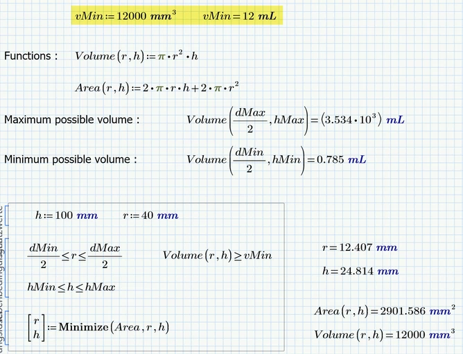

I want to optimize solution based on conditional operators in Mathcad Prime 8. Please help
Werner_EAnswer
Feb 7, 2024 12:56 AM UTC
Working from rgunwaldsens sheet:
You can use Minimize just to minimize ONE function, not two.
Feb 6, 2024 8:27 PM UTC
Ths problem s not well posed -- the minimum volume cannot be attained within the llmits imposed upon the dameter and height.

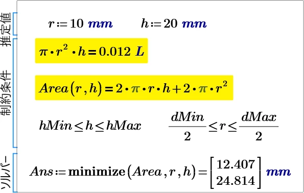

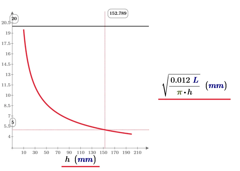

ttokoro
Feb 7, 2024 12:16 AM UTC
min base area
t.t.
