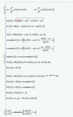

I have to solve and ode which includes some equations. Now I can not calculate it because it says variabe undefined.
Why that?

OK, after a further look at your sheet I realized, that my advice of turning all functions into functions of t wasn't a good one. It should have worked (but for some reason it doesn't) but it sure was unnecessary.
The only advice which is to follow is to put the functions outside of the solve block (so you can also use them after the solve block).
I edited your last sheet (is attached) accordingly and now it works as supposed. Sorry for the confusion.

You have not defined the function z2(t)  so Prime protests.

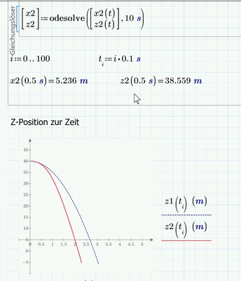

Attached the worksheet. I already figured out that it works if i define my equations as function from x2 and z2 and only the ode as function from x2 z2 and t.
Is this correct?

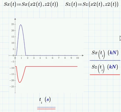

But now I want also plot for example Sz and Sx but i do not know how.
Maybe the whole approach is wrong.

I've only got Express, so I had to work around the ODE solve blocks.
Attached Prime 6 Express.
